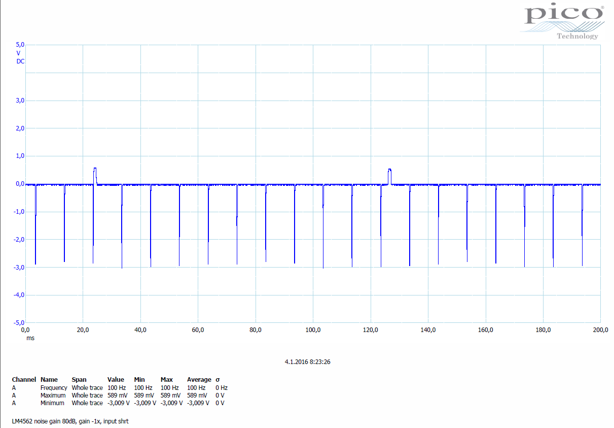

Now, BJT input opamps - and it is a completely different story. Same setup, nothing has changed, only opamps in the socket. See NE5532 and LM4562 results. For LM4562, I am attaching the time record as well, to see what is happening. The 100Hz peaks are slowly traveling along the curve shape. Together with slower, almost rectangle superimposed peak (not seen in this plot).

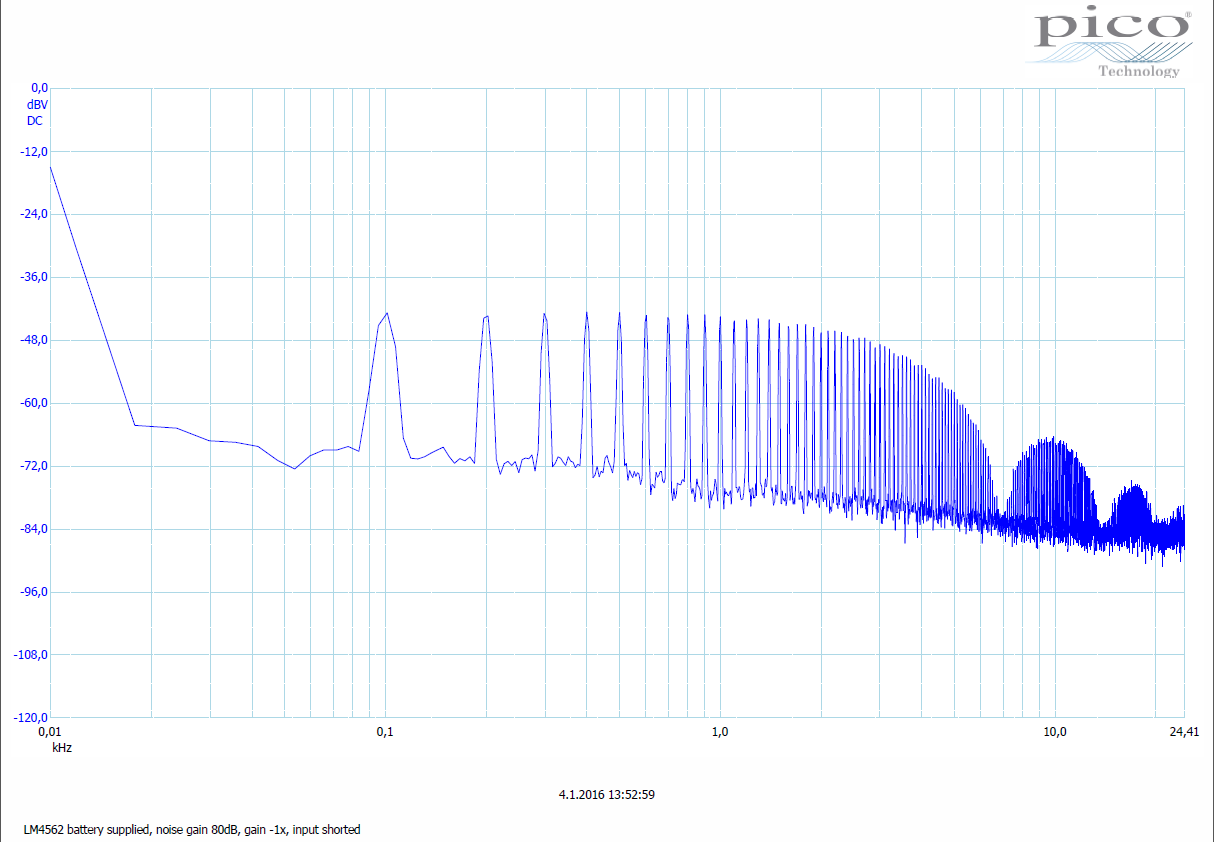

Obviously you have measured nonlinear distortion. The 100 Hz fundamental is very clear, and so the remaining spikes at multiples of 100 Hz are harmonics.
Running these op amps at gain of 10,000 varies considerably from their recommended use. If you want to run gains like these, you should be running op amps that are designed for it - they are the common types used for microphone preamps.
Please take into account that this last set of measurements is without any signal generator. The input is shorted with 50 ohm terminating resistor, output connected to scope. So it cannot be "measured nonlinear distortion".
I know these EMIRR sheets you are linking. What is your personal experience and background in measuring EMI? My is design of special instruments for High Voltage and High Power testing laboratories. Measurement of discharges in SF6 HV circuit breakers etc.
Received some questions, I will reply here.
1) It is there even if battery 2x9V supplied. So no excuses to PSU ripple.
2) Input is shorted with 50 ohm, no generator connected. It catches 100Hz from the air.
3) Three independent instruments measure the same. Oscilloscope, USB oscillosope and sound card.
I would appreciated your thoughts, but not oversimplified armchair guesses.

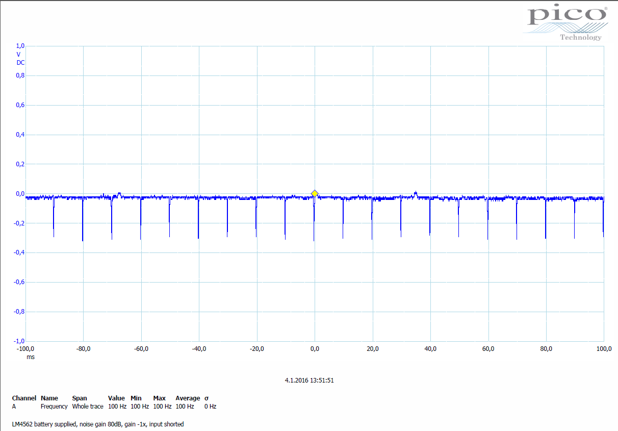

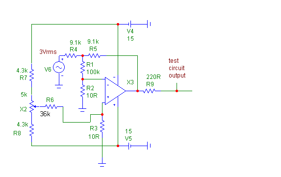

Since you couldn't derive the correct noise gain figure yourself from Pavel's schematic, I don't know if you have the right background to appreciate an explanation, but I will attempt to do so anyways.
Any deviant signal caused by EMI can be seen as an internal error source generated by the opamp. As you may be aware, this is the region where NFB is effective by referring the output to the input, and by correcting for delta's. This mechanism is not different for distortion or other internal errors such as produced by EMI. By shunting part of the feedback to ground, the noise gain can be increased without influencing signal gain. (The noise gain is determined by the ratio of the feedback that remains available for error correction, plus the signal gain, so you know for the next time). In short, increasing noise gain is a valid method to appreciate the impact of emi on the functioning of an opamp.
There is no limit to the amount of noise gain one may introduce, it depends on what the scope of the investigation is. So, 80dB is a lot, but if it is needed to show the issue at stake, what would be your problem with it?

Looking at your results, I more and more believe you are seeing the DUT operating for some reason in open loop mode.
The LM4562 OL gain is 2 or three orders of magnitude greater than the 5532 or 5534 so this it could be hypothesized is the difference in output level you are seeing. What is also interesting is that your circuit source impeadance are very low (10 Ohms IIRC). Surely the coupling from your hand to the inputs would reflect that?
