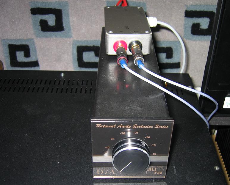

Hi John,
this is the same principle. The grey box has conductive foam inside.
regards,
