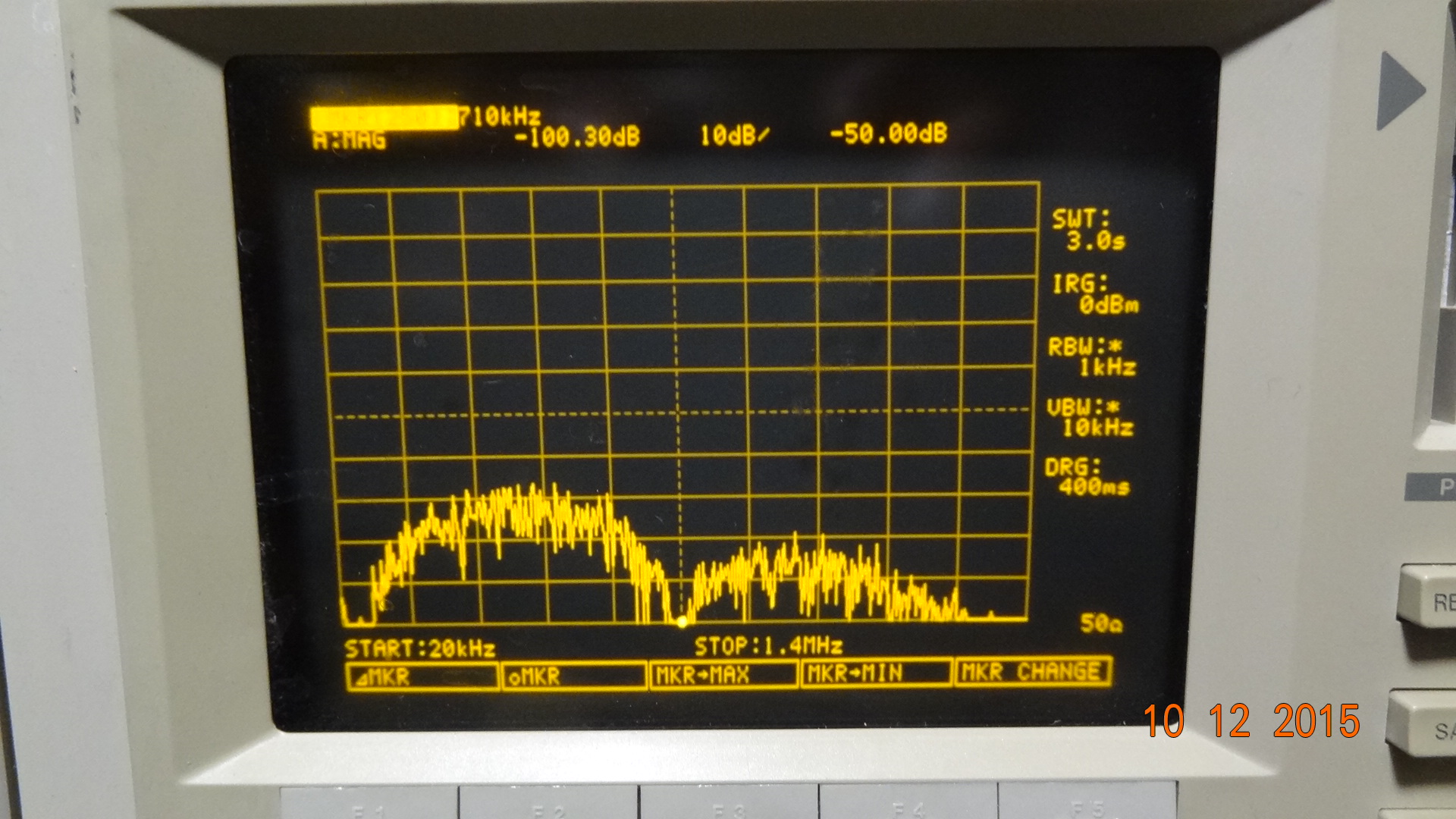

You are going over old ground... i am well past that. Didnt you see the output spectrum I showed here? There are also idle tones seen. I would like to think none of us have to listen to such gear... but apparently, we do. My CD player tested for extraneous HF noises is the Alesis Mastering CD recorder.

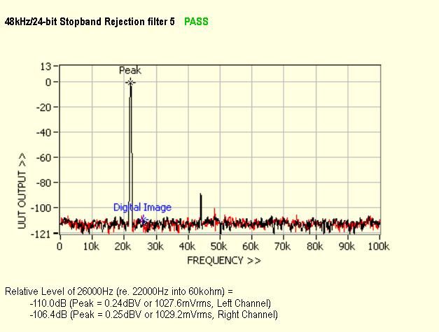

Now I see what the fuss is about. That spectrum is completely typical of a DAC without an image filter (that's really cutting corners). Somewhere I have the same spectrum photo before and after a simple LC filter. Without much effort all the junk was reduced by 70+ dB.

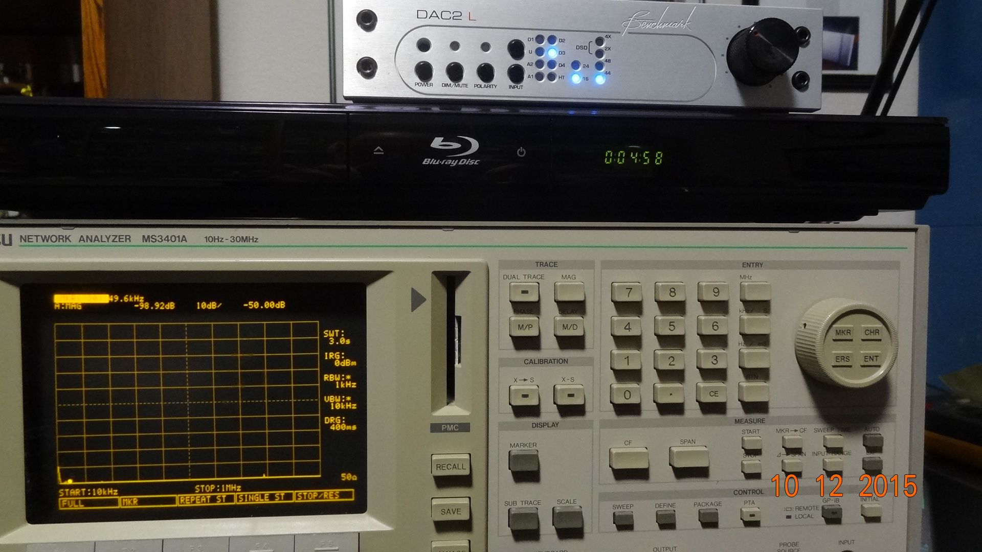

And, if you take that same CD/DVD/3D player and run it thru an 1800-2000 USD$ converter via coax/digital I/O ports, you get No HF trash to cause increased distortion.
The Alesis was 800 USD$ new and the CD/DVD/3D player is about 300-350 USD. Used ones shown on eBay are about half the new price.
I'll also check some other players but there might be a general price point you dont want to fall below to get the max performance; I wish we knew which were the exceptions but magazines and equipment mfr do not test above 20-30KHz. You are on your own. But might ask for such info before you buy from mfr. If budget is tight, an external LPF is cheap enough to make.
