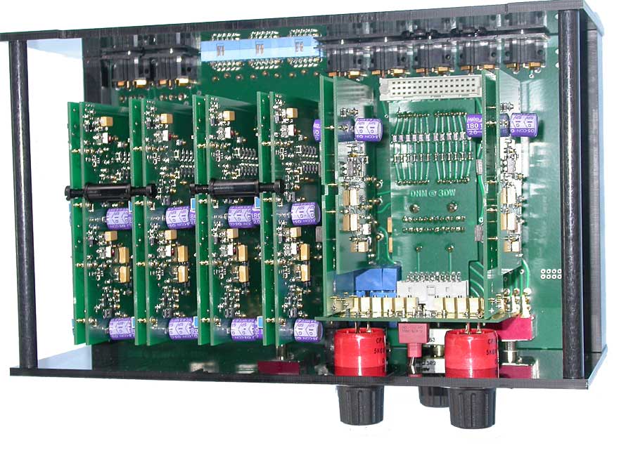

Dennis Morecroft in England ( DNM ) uses as little metal as posible so there is a skool of thought that any conductive and permeable material should be avoided near the circuit.
I have a DNM pre that sounds great but i find it hard to minimise hum from the phono input.
This sounds a bit like snake-oil, Joachim, especially if the material is not heavily non-linear. Copper surely does not "worsen" sound. Probably he might like EMI induced into the circuits - some really do prefer less defined sound resulting from more interference.
He makes a major efford with star earting and bandwidth limmiting but anyway, this is not how i whould build. Still PMA, look at what he does. It looks pretty and i was able to learn from his work.
