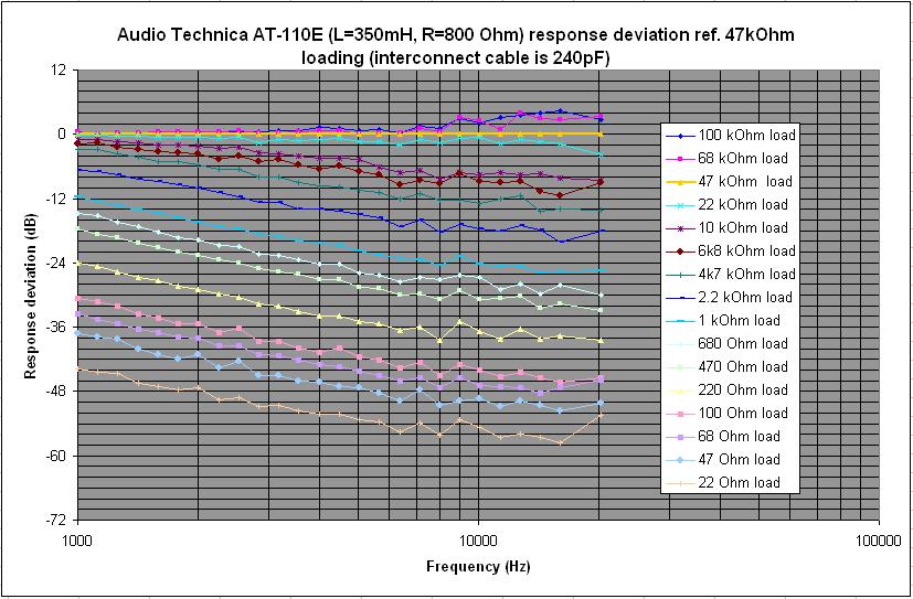

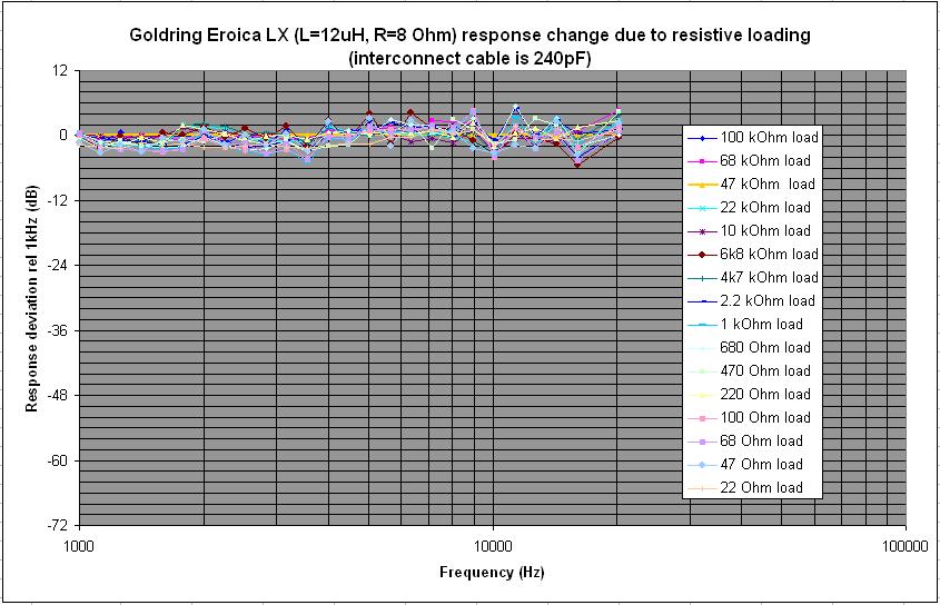

a phono stage that commences a rolloff due to overdamping of the nominal cartridge at 6.8kHz. That is, -3dB already at that frequency. Clearly the designer did not understand cartridge loading.
(This is a side outcome from some measurements intended for Scott’s concerns over cartridge efficiency)
SY is right. Resistive loading greatly alters the frequency response of cartridges with high inductance coils. Freq response of low inductance cartridges remain less affected.
There is no mystery. Measurements (as the attachments) follow closely LR simulation results.

And yet the manufacturer claims response to 20kHz, while loading a 1.3kohm + 700mHy cartridge with the equivalent at high frequencies of about 24kohm! With the stated C loading, that equates to an electrical response down 13.5dB at 20kHz! With the stated loading C of the preamp, -3dBr at 7.3kHz.
I am sure they used a signal generator and not a cartridge to determine the specifications.
Of course there is no mystery, other than why no one notices, with the cartridge, the absence of at least an entire top octave!
If I correct the loading, I'm bracing for the complaint that the top end is suddenly tizzy. Unless, as I have suggested, hardly anyone has any auditory response up there anymore.
