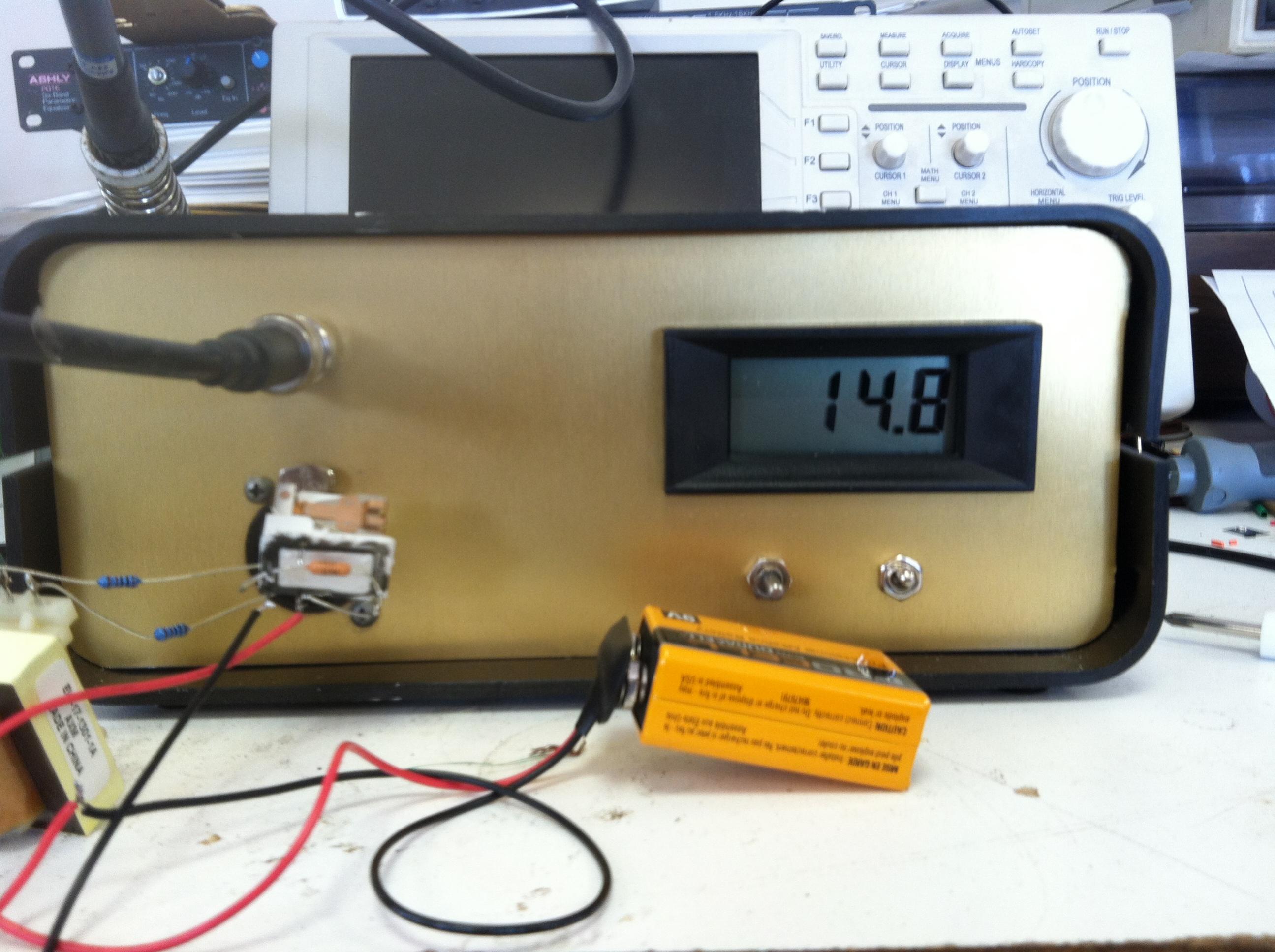

Here is the loss across a small signal relay with silver contacts. The source is balanced 1000 ohms to 1 ohm to 1000 ohms with the relay across the 1 ohm resistor. The open circuit voltage is 1 mV and the closed circuit voltage is just under 15 uV at 10,000 Hz. That corresponds to 15 milliohms of contact resistance. So the issue under test is if the resistance is ohmic with regards to level and frequency.
Turns out the voltage across the contacts drops by 15% from 20 Hz to 20,000 Hz.
Is that your take on the HP 4328A Milliohmeter? It used AC excitation (for a whole lot of good reasons) and measured only the resistive vector.
Verifying over a frequency range is really difficult. I found that at milliOhms the inductance of a short wire can be significant. What you may be seeing is the inductance of the series impedance affecting the reading. i know low inductance milliOhm resistors are not common. In fact they are really hard to make. I believe JNeutron showed one way and that would be a good starting point for checking the test system.
I was given a copy of a manual for a Siemens contact tester that looked for momentary variations on contact resistance. I was interested but the instrument was far too involved to hatch a copy. Essentially it applied an HF signal across the contacts and any variation in the amplitude was recorded.
