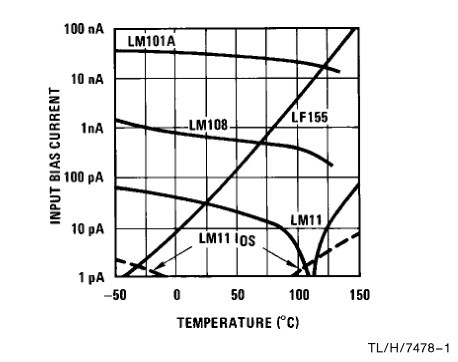

The other thing to worry a bit about is regardless of how low the bias current is at 25C ambients and quiescence, it doubles for about every 10 degrees increase. Still not likely a concern for reasonable external impedances, as would be used where possible to keep thermal noise down at or below the aforementioned 5nV/sq rt Hz, but just something to keep in mind. I remember in ye olde days when superbeta input bipolars were being compared favorably to JFET inputs at high temps.
The OPA1652's input offset current reaches a fairly staggering 1.6nA by 85oC. Presumably that's the leakage currents of the input protection diodes as the IPS is CMOS?
Added plot of leakage from Widlar's NS AN-241 on high impedance opamps.

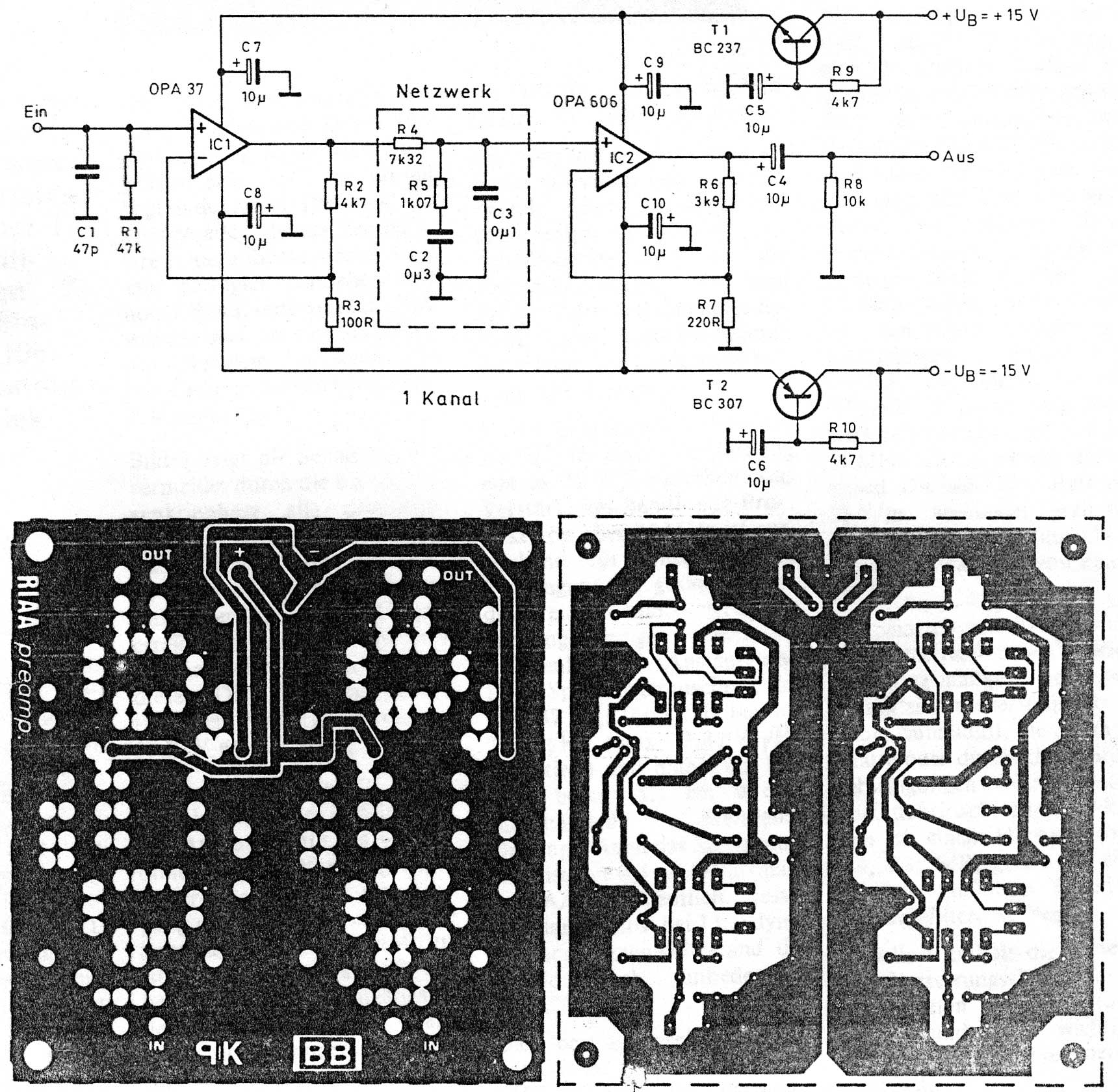

In my admittedly small experience, adding the output discrete current boost transistors usually made the biggest impact on the high range, rather than the bass lines, one might automatically assume for current boosting.
Some years ago, I was rying to use an OPA 275 op amp for a RIAA phono stage, along the lines as it was then used by some models of Harman/Kardon and Rotel. It worked well enough, but the treble just seemed to be dragging its feet somewhat. All right, but that's it, not as good as the midrange and bass. Fortunately, if anything I tend to overdo PSU bypassing, so I had ready and waiting additional bypass places and holes next to the usual 0.1uF next to the op amp, and I added encapsulated 10uF/25V tantalum caps in parallel with the 0.1 uF caps. This did clear up the treble range, nothing spectacular but the fact that I could hear it was reason enough. Now a part of this could be balmed on the quality of the PSU, which was a standard job using 7815/7915 regs, but that's how they are usually delivered anyway.
Just to check myself, I somehow managed to do the same on the H/K (no space on the Rotel), and indeed, I got a very similar result. I remembered then that I had once in fact seen this done in a project published in a German magazine, by one Holger Hermann, working for Burr-Brown in Germany, weho did the same and skipped the 0.1uF cap altogether, and relied on a tantalum 10uF/25V caps only. It wored well. Yet, everywhere else all I saw was the usual 0.1 uF cap, no doubt simplier and cheaper, but it seems insufficient method. Perhaps there's something in that?

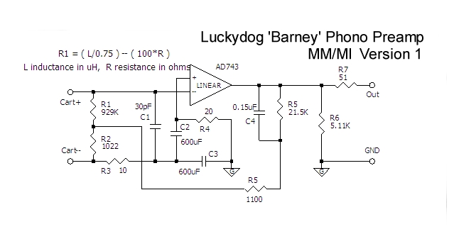

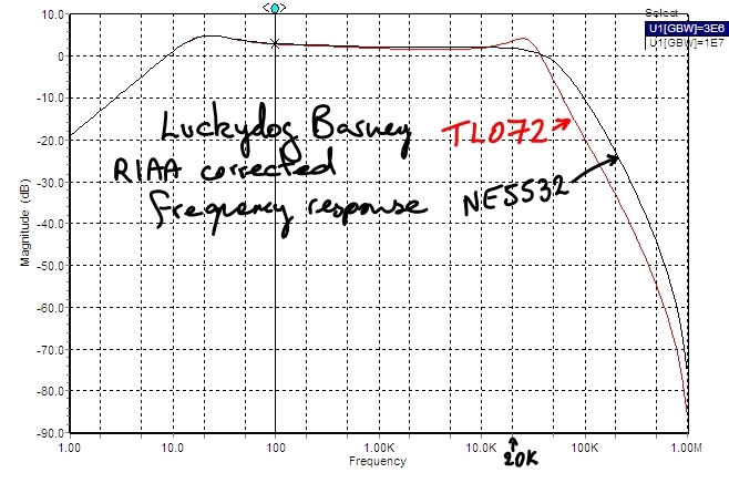

Here's an illustration of how it is readily possible to design an audio circuit which accidentally relies on backwater parameters of an opamp, and where rolling therefore can have a tangible and audible effect. It is equally possible to design a circuit where it doesn't.
A few years back I designed a phono preamp based on an op-amp implementation of Barney Oliver's very nice discrete transimpedance diff-amp circuit. I overlooked GBW spec, as one might. However, the circuit is demanding of GBW, and it took ages to work out why the real circuit behaved differently from sims, and was very dependant on specific op-amp as to top end sound and f response.
Attached is an old plot showing difference between TL072 and NE5532 in that circuit, in terms of f response. This is entirely an artefact of the circuit: it would be readily possible for this not to happen at all, or to happen to an even greater extent depending just upon the circuit.
There's nothing wrong with NE5532/4 or TL072 in audio circuits (enough fine mixing desks are full of them), but it can be a matter of horses for courses as to circuit application, sometimes by complete design oversight.
