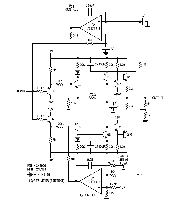

Did anyone have original schematic of one very rare GAS -Godzilla- A(b) class power amp ?
Is that Iq cap really .05F

And are they really running 3904/3906 at about 1.2W? Methinks the notation that says all the Q are one or the other is a trifle off.Is that Iq cap really .05F.

Schematic is accidentally downloaded by me from here ,by searching for substitute for one LT....IC video driver which I need for repairing of one old PC-CRT monitor .
