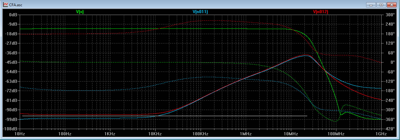

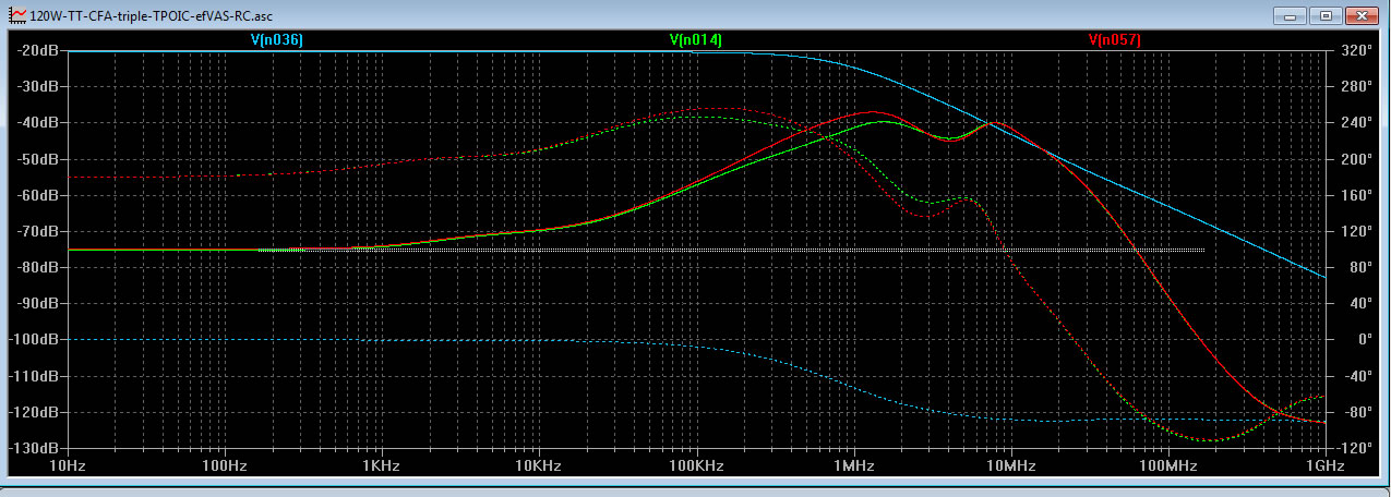

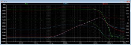

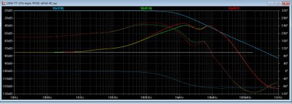

Dadod, attached two simulations: your amp, and a real CFA.
See the difference in closed and open loop bandwidth. A x10 factor in higher frequencies, both Open and closed loop.
Sorry Esperado, I don't see anything from those plots as I don't know what schematics you've used and how you've simulated it. Better, if you like to proceed this discussion, we use "Unique" thread.
dadod, your feedback ratio begin to decrease at 1KHz. No surpise you don't see any difference with feedback impedance.
Everything was explained about this simulations in my previous posts.
My purpose was not to criticize your design, but to help-you to understand what a CFA is.
Unless you achieve to add stages faster enough to introduce no openloop bandwidth reduction, you cannot do-it. CFA are in the spirit of Kartings, you cannot design them like a limousine (VFA way of thinking).
With the actual available device's speed on the shelf, you need to get a flat openloop bandwidth up to 10KHz. That is the goal. After this, you can try to add complexity in order to reduce distortions, taking care to not destroy original speed, or adding unwanted poles, not good for stability.
