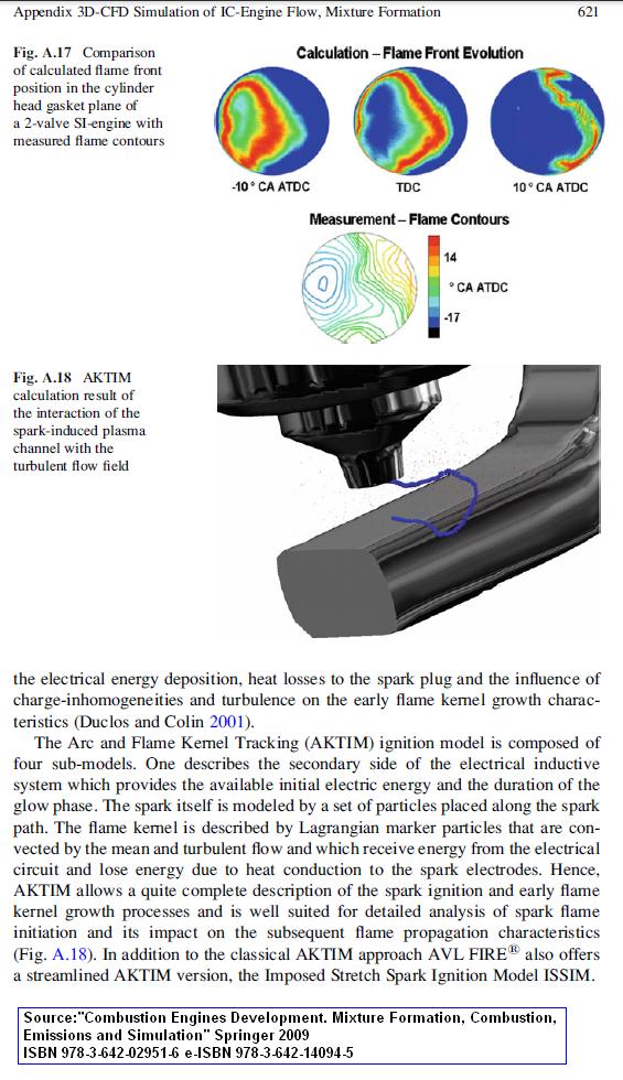

Just before Scott activates the "ignore car talk" button.
The ignition system was a whole another project to keep pressures from killing the spark
It's not only high static pressure 🙂
