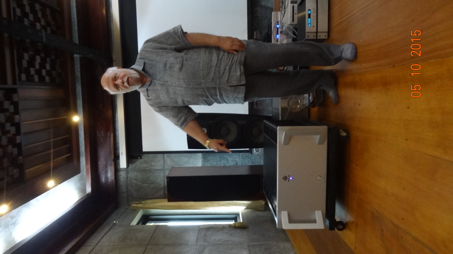

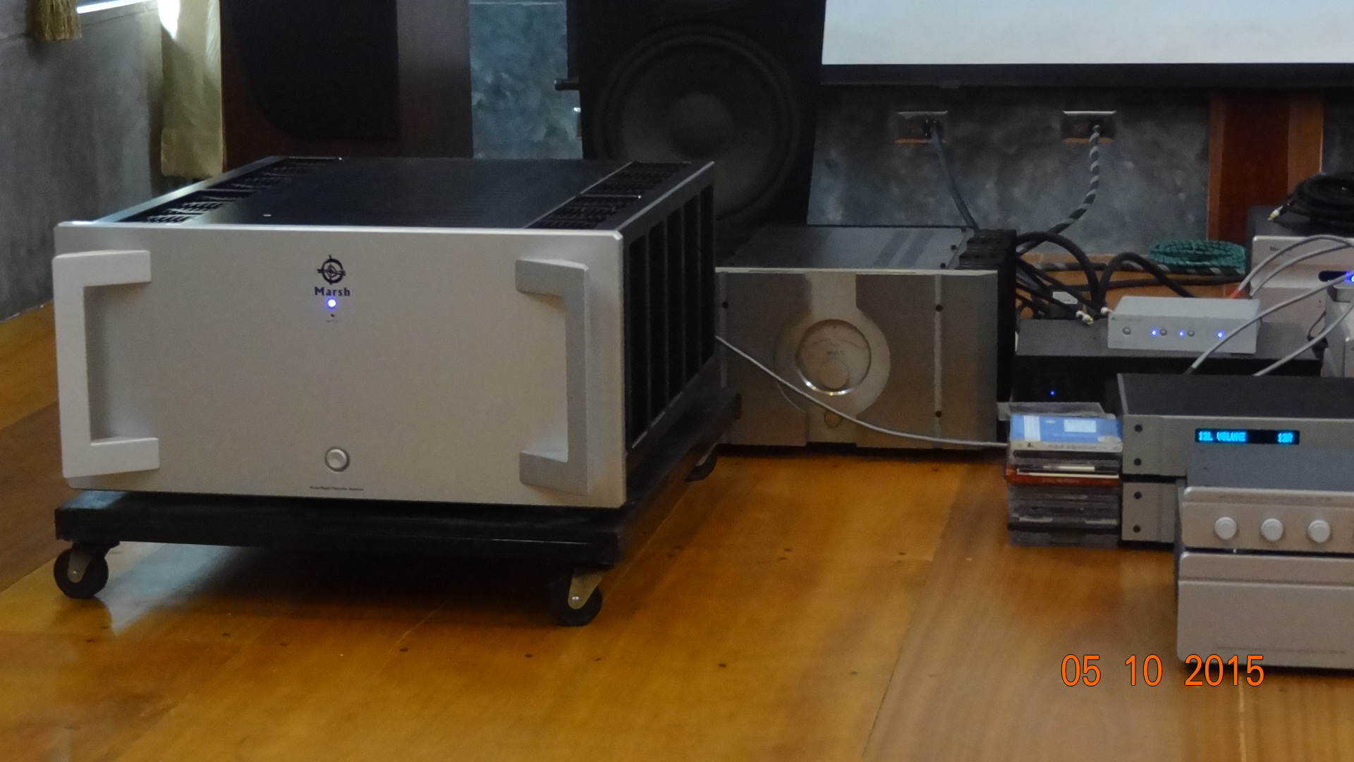

Now here you have my version of wretched excess. But that is about right for me. Each mono-block weights in at around 550 pounds ! Huge C-core transformer. CFA design (of course). >450v/usec. Distortion? What distortion? Power output? Cost? Don't ask. Yes, thats a class-A N.Pass amp dwarfed in the background.... and you thought That was a big size amp. These are in the listening room of Dr Kung down in Trang, Thailand (near the Malasia border).
Well, someone had to do it.
THx-RNMarsh
RNM you are looking good! But about the amplifier, around here we don't use handles on big things we used forged hoist rings. Makes it easier for the crane to lift it.
