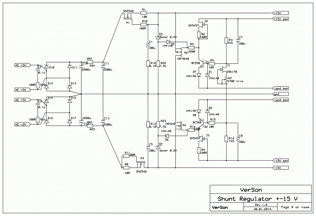

Well Kamis, you have a legitimate question. I did, in fact, design a complementary shunt regulator into the CTC power supply, and I did not publish that part of the regulator circuit. It did not work as well as I had hoped, and it was prone to thermal runaway, so I will not publish it now. I do recommend a shunt regulator to be added to a super power supply, so any suggestions?
Does it mean that 40 people have a problem with burned PCB-s ? What is exactly super power supply? What type of regulation do you use in Constellation phono stages?Well Kamis, you have a legitimate question. I did, in fact, design a complementary shunt regulator into the CTC power supply, and I did not publish that part of the regulator circuit. It did not work as well as I had hoped, and it was prone to thermal runaway, so I will not publish it now. I do recommend a shunt regulator to be added to a super power supply, so any suggestions?
No, I think I am the only person who had a big problem with the shunt regulator. It just took a lot of adjusting up front to keep it working properly over time. It was only the Vendetta portion of the power supply that had a potential problem, as the output voltages were necessarily lower to operate the Vendetta phono boards. +/- 24V rather than +/-30V for the line stages.
In Salas' thread on "simplistic" shunt regulators, there have been some designs proposed and realized. Preamp (his forum name) suggested dual 15V ones, which allow current sources with healthier voltages by referring them to the opposite rail. He's built something and is currently trying to get noise measurements.Well Kamis, you have a legitimate question. I did, in fact, design a complementary shunt regulator into the CTC power supply, and I did not publish that part of the regulator circuit. It did not work as well as I had hoped, and it was prone to thermal runaway, so I will not publish it now. I do recommend a shunt regulator to be added to a super power supply, so any suggestions?
In between paying work I've been doing some designs as well which have not been realized yet, except for a very-low-noise temp-stable voltage reference. The plan if time permits is to build a tracking regulator and make it temperature-stable within reason. Target is 200mA of current per rail. The error amp front ends will be bipolars from the obsolete low rbb' series from Toshiba, 2SA1316 and 2SC3329, and run at about 7mA per device. Except for 1/f noise the overall output noise should be in the low-hundred nanovolt rms range, in a 22kHz noise bandwidth.
Simulations indicate a transient response with a time constant of about 170ns and very little ringing for a step current change of 20mA. Should be a pretty decent regulator and readily scaled to other voltages and currents.

I used this shunt regulator in my GainWire mk2 preamp.
It works pretty well.
Damir
Noise is a little lower with 10mA for the string. Possibly a bit of a bulk resistance thermal noise effect.In any event the 400pV number mentioned by SY for some LED(s) seems plausible.
Do you recall what the temperature coefficient of the output voltages are? There should be partial compensation of the error amp input voltage by the probable tempco of the 2SK170 current generator.I used this shunt regulator in my GainWire mk2 preamp.
Damir
