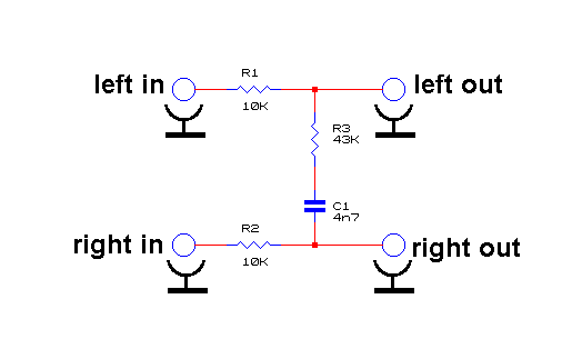

Regarding the phono v digital issue, I ran across an interesting site of Richard Brice a while back, who also published in WW, where he states that the problem with digital may be due to too much channel separation!
As quoted from his web site:
"Several years ago I was involved in my first recording which appeared on vinyl and CD. It gave me a unique opportunity to compare analogue and digital reproduction because I also had a copy of the original master tape. Unhesitatingly, I should say, the CD was 'nearer' the master, but vinyl produced a 'better' stereo image - in fact, better than the master tape! A conundrum indeed.
After much deliberation and armchair theorizing I set about doing some experiments. Late nights with an oscilloscope eventually uncovered that electrical and mechanical crosstalk within the cartridge and pre-amp were causing a stereo image manipulation which was similar to that brought about by the Blumlein 'Shuffler' circuit and Edeko's loudspeakers - all the important narrowing of the stereo image at high frequencies. It supported what I and so many hi-fi fans knew to be the case, that vinyl really does sound better than CD - especially in LP's presentation of a realistic soundstage."
A commercial product called "Francinstien" supposedly corrects the problem. On his web site, he has two mp3s, one processed and one unprocessed for comparision.
His web site is:
Perfect Pitch Music . Richard Brice . composer . inventor of FRANCINSTIEN
The link to his Francinstien info is here:
Francinstien
Several years ago we communicated by email, and he sent me the attached schematic of a simple circuit to use to get the basic function of his product. Since then, he has revised the Francinstein (2010), as discussed on his web site.
