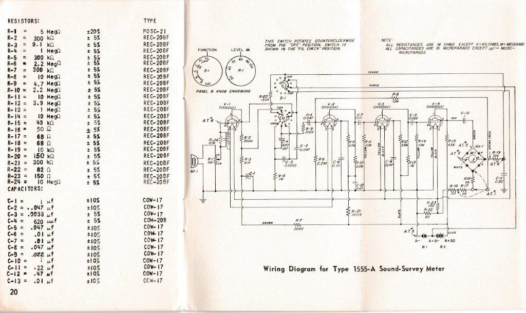

Now previously I had posted this schematic of a General Radio sound level meter. I have a bunch of them and they all came in bad. I did ask if anyone cared to guess which part always failed. No one did. They use carbon composition resistors and in my oldest one I did replace the unit tied to the first stage plate as it was noisy enough it limited the lowest range. I had one unit with a shorted capacitor. As the capacitors were all metal and glass cased everyone other than that tested was within value.
Now if you look at the first stage you can see that the maximum plate current should be 50 uA as the plate runs at 10 volts it is even less.
Now just for Marce the unit is built on a phenolic board with inserted terminals. The PC boards of the day had too much leakage current for this application.
A close look at the schematic will show the power/range/battery test switch. It is a single layer phenolic switch. When anyone cleaned the switch or perhaps even the original lubricant that left a residue. With age and the close spacing of the common power lead to the B+ voltage this residue would drop the plate voltage to around 1 volt. The B+ test position would indicated a weak battery even with a good unit.
Yes all of the selector switches failed! Using a cleaning spray did not work. The solution was to remove the switches, give them an alcohol bath and then to carefully move the conduction rings retaining crimps a bit to increase the separation.
Now today when working with microamps we would use a guard ring. But there really are cases where special laminated base material is actually an issue.
BTY the meters were first introduce in April 1952. They still work well! Need to buy some more as a few folks want one!
