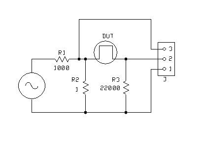

Ed has explained the experiment as measuring across the looped conductor (at the xlr connector) ie...
Run 5 mV through a 3' cable terminated with 20K. Look across the cable with a differential input complex FFT and see how the losses vary with frequency across the audio band. The voltage will be down in the dirt as the cable resistance is about .003 ohms. So if you use lots of samples and only look at .95 F to 1.05 F it should be possible to pick out the loss signal and phase.
The loss goes up with frequency. The inductance of the wire is less than 50 nH. At 20 kHz the reactance of the cable should be .007 ohms. The loss is greater than that. You can repeat the experiment with the same length of a thinner wire such as a single strand from a cat5 cable. The low frequency loss on my rig is higher but the high frequency loss is lower.
Dan.
This was my first circuit. I would suggest using 100 ohms instead of 1 ohm as that would be a better representation of an audio source. The IEC load spec's call for 20K or greater. 22K should work higher values will drop the signal we wish to look at.
Try the test with .005 volts into the cable under test. Try frequencies of 110, 316, 1100, 3160 & 11000 hertz. Use a 32,000 point or greater FFT average at least 128 runs and look at the frequency under test from .95 F to 1.05 F or even tighter .98 F to 1.02 F. Then repeat the test with .5 volts.
I would suggest using two cables one 10 gauge (5.26 mm sqd) and one 24 gauge (.2 mm sqd.)
The loss in the wire would be shown by the voltage across it. At .005 volts DC the voltage should be around .7 nV for the 10 gauge wire 3' long. It should rise to just above 1.1 nV at 11,000 hertz.
Then please let me know if you observe anything interesting.

The thinner wire has less loss as a percentage of the toal change within audio freq range. IOW.... the loss is constant out to a higher freq. See N.Pass work.
Do you have access to a Network analyzer to measure the DUT Z vs Freq?
THx-RNMarsh
Actually the thinner wire had less total loss across most of the audio band. Not just percentage basis.
No network analyzer. I almost bought one but it was selling for $200 from someone who had never sold anything like it, so I though it was a fraud. Turns out it was real and sold for $200!
I can get the Z from the complex FFT

You are right I am not seeing 1 nV that is below the noise, what is interesting is where the signal is cleanly above the noise. The 24 gauge wire has 17 nVish at DC and that is just seen at 110 Hz.
The AP has a feature called optimum sampling rate for any given bandwidth. I usually use the maximum which is about 50K for my model.
