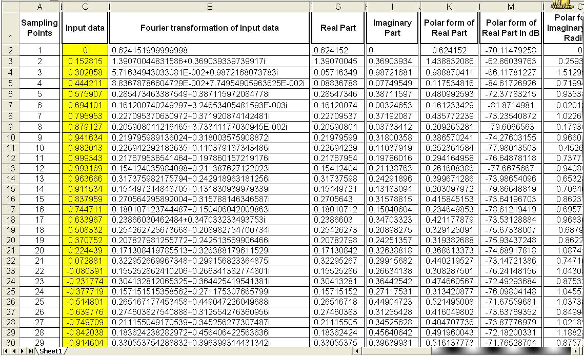

Aside, did you know that Fourier Transform results are naturally complex numbers, even when fed with entirely real time samples? That is to say, the result includes phase info for discrete frequencies, which fact is generally disregarded or ignored for reasons unknown.........same is true of heterodyne detectors, in a very different way of course........
I had made a spreadsheet doing FFT just for the phase info. You can see the complex numbers
http://www.diyaudio.com/forums/software-tools/195457-spreadsheet-can-do-spectral-magnitude-phase.html#post2688368
George

Thanks, George - yes that's right. A common sense explanation is that a fourier transform converts the waveform time clip into a set of discrete sinewaves of frequency, amplitude and phase. Which, when combined, describe the waveform for the time clip. In this way, the result contains both amplitude and phase info for all discrete frequencies in the sample waveform.I had made a spreadsheet doing FFT just for the phase info. You can see the complex numbers
George
Just that no-one bothers to present the phase info.........
BTW Excel's FFT has limitations but produces correct results. To overcome restrictions of, say, sample size it's better to borrow VB code and insert into a macro. I wrote one for myself, will dig it out if I can find it and post it.

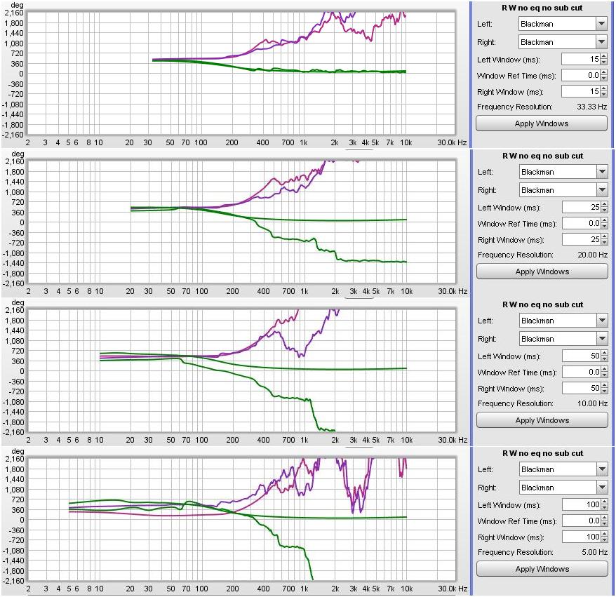

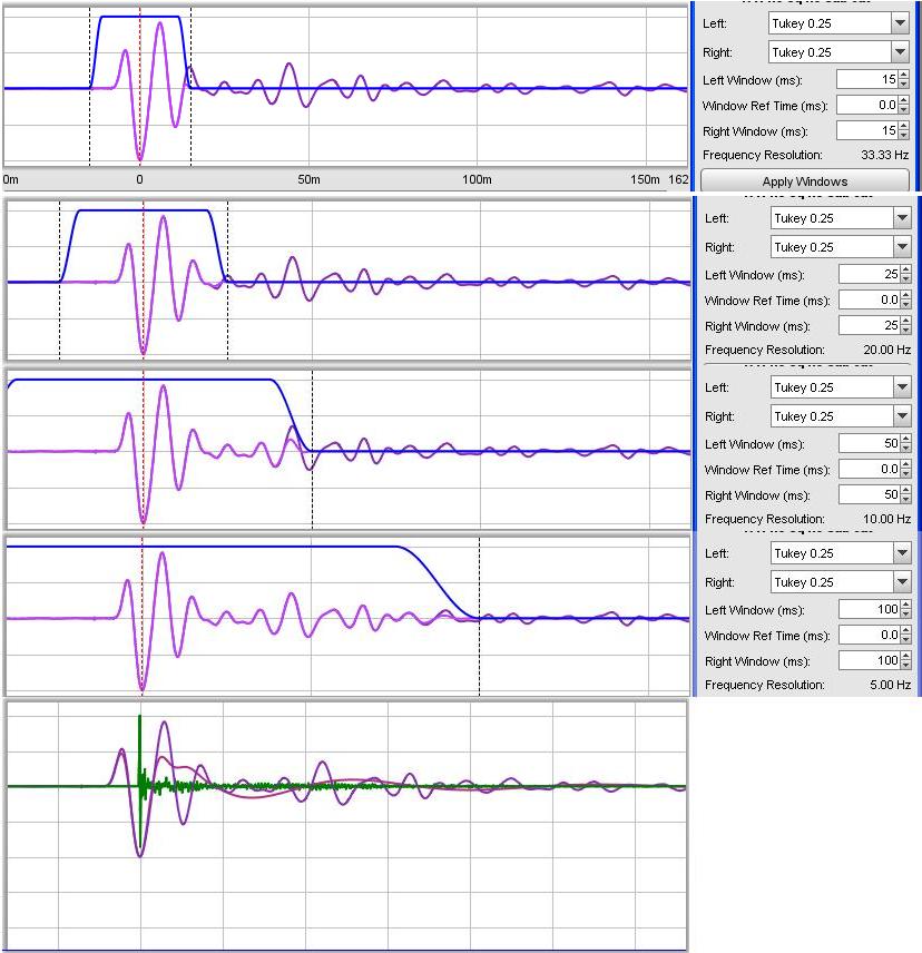

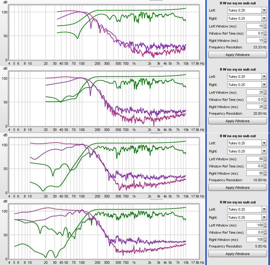

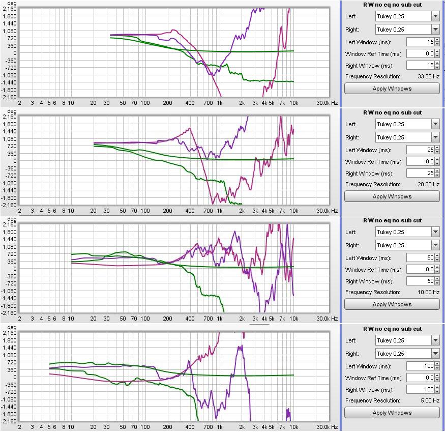

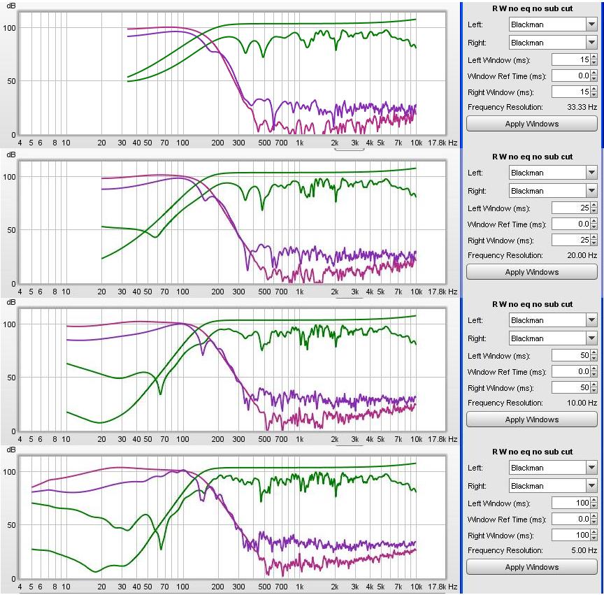

George;
Your results are disorienting and disoriented.
Phase plots of electrical response correspond to wrong point for t=0.
If FR plot shows real behavior of woofer it is passing way too much signal both below 20Hz and above 200Hz.
15ms-25ms half windows of a Blackman flavor likely will give you the most useful information. Look for window that shows deepest null at crossover with polarity reversed on one of the drivers.
Barleywater
I followed your advice. I hope the plots now make more sense to you (they are from the same scenario: LP & HP 48dB/oct LR at 140Hz, electric and acoustic measurements)
Review them and tell me please which of the window functions you find as most appropriate in this case for extracting meaningful results (and if possible why)
George
