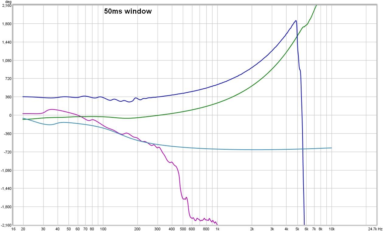

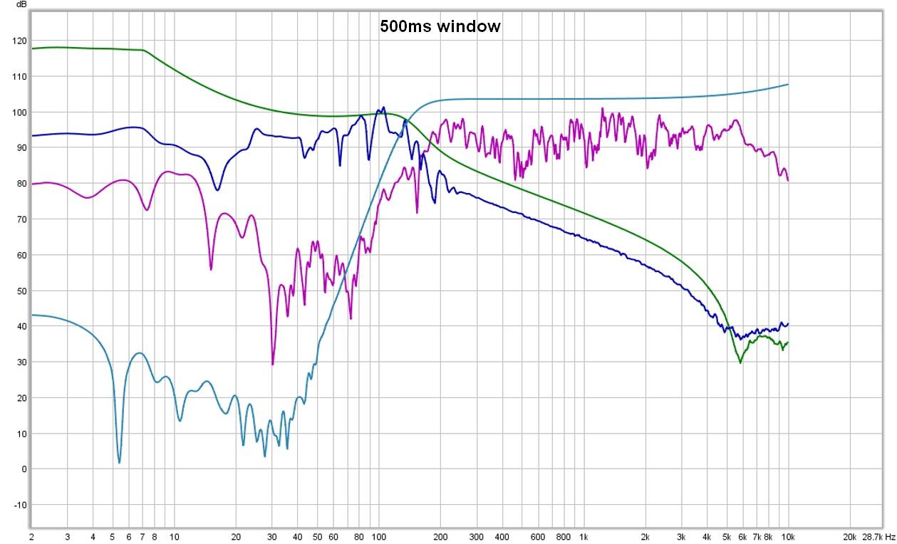

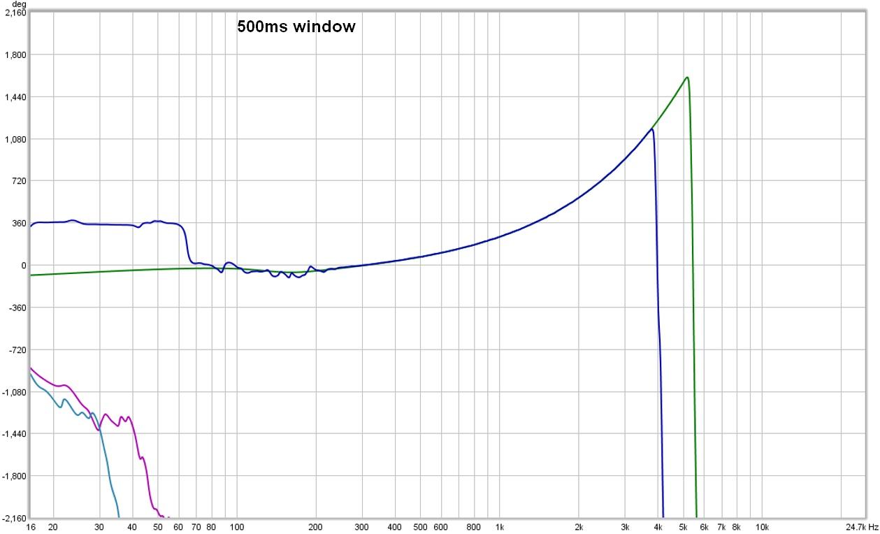

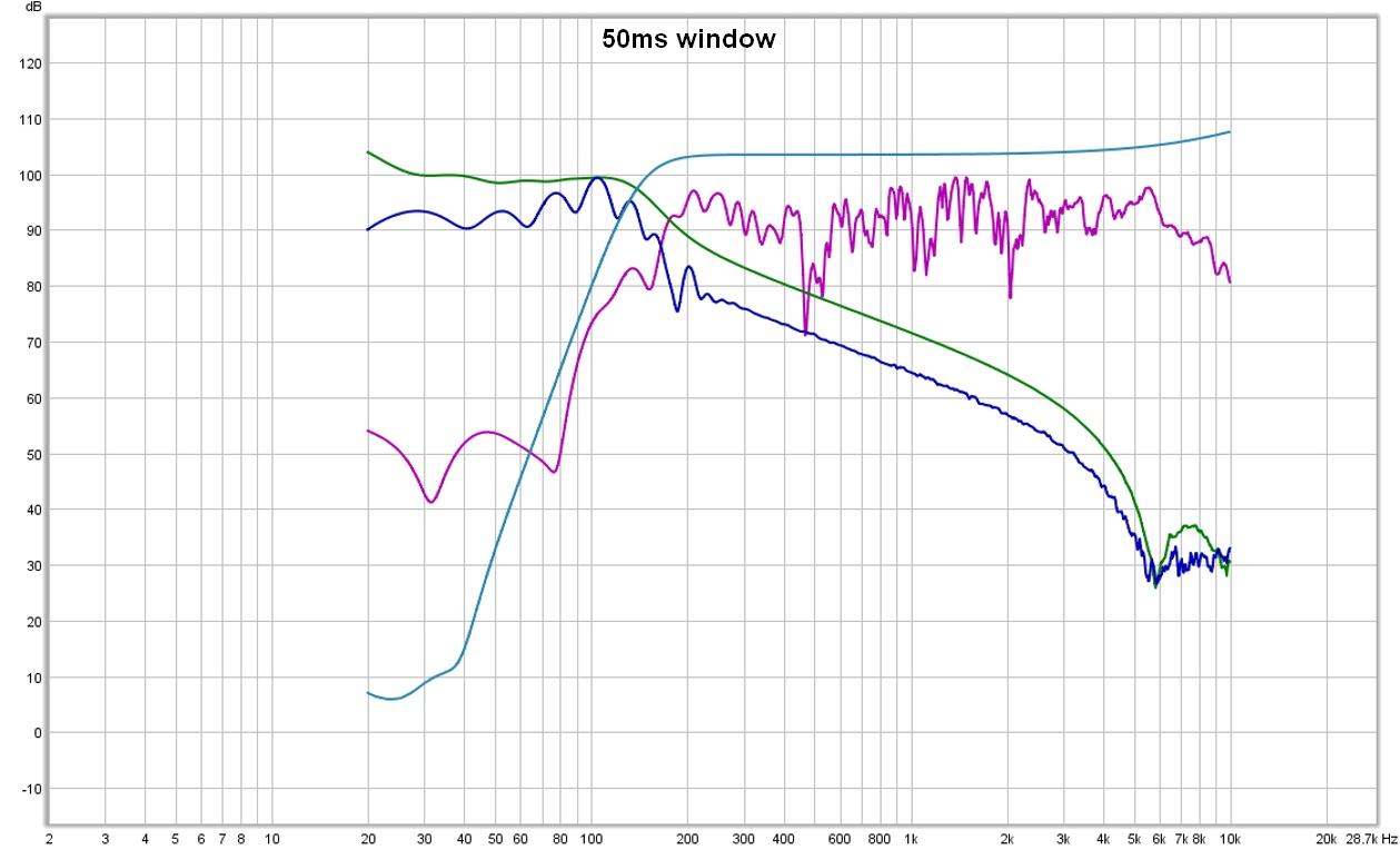

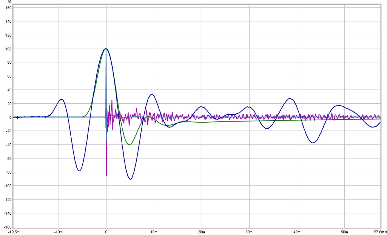

No smoothing, mic 1m from OB speaker in my living room.
50ms window and 500ms window.
We listen the way we listen. When measuring, who is to say if the 50ms window plots are closer to what we listen, from the 500ms plots or vise versa?
George

George;
Your results are disorienting and disoriented.
Phase plots of electrical response correspond to wrong point for t=0.
If FR plot shows real behavior of woofer it is passing way too much signal both below 20Hz and above 200Hz.
15ms-25ms half windows of a Blackman flavor likely will give you the most useful information. Look for window that shows deepest null at crossover with polarity reversed on one of the drivers.
