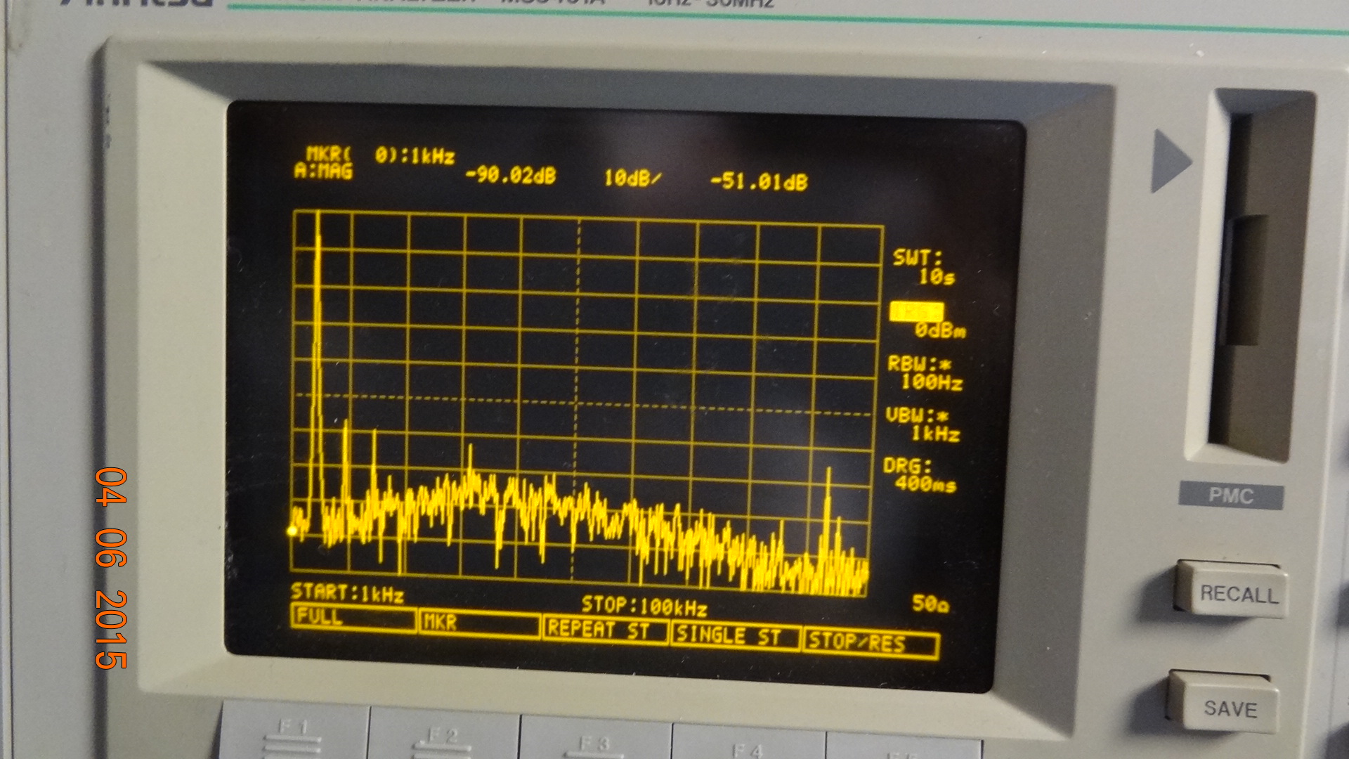

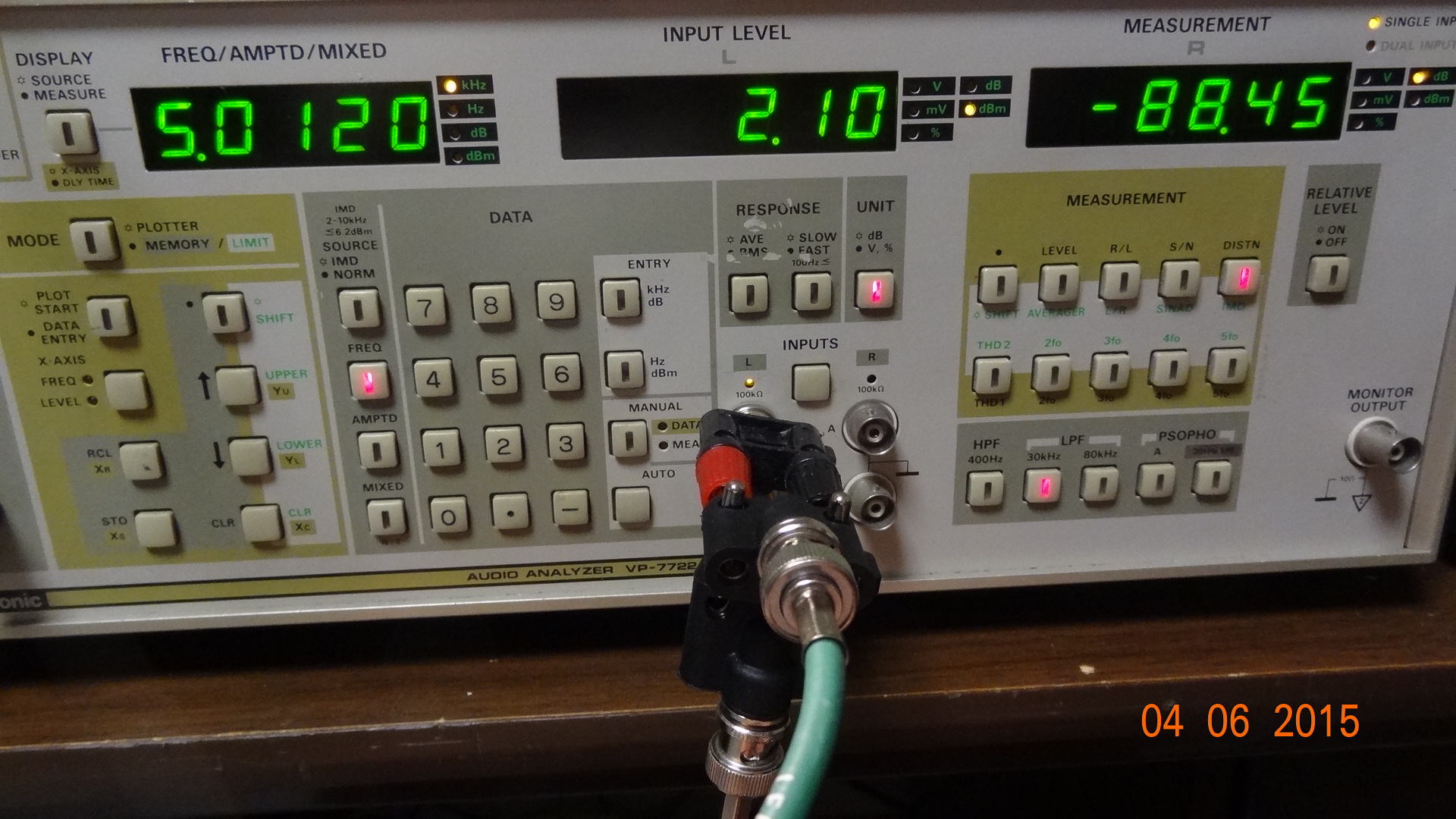

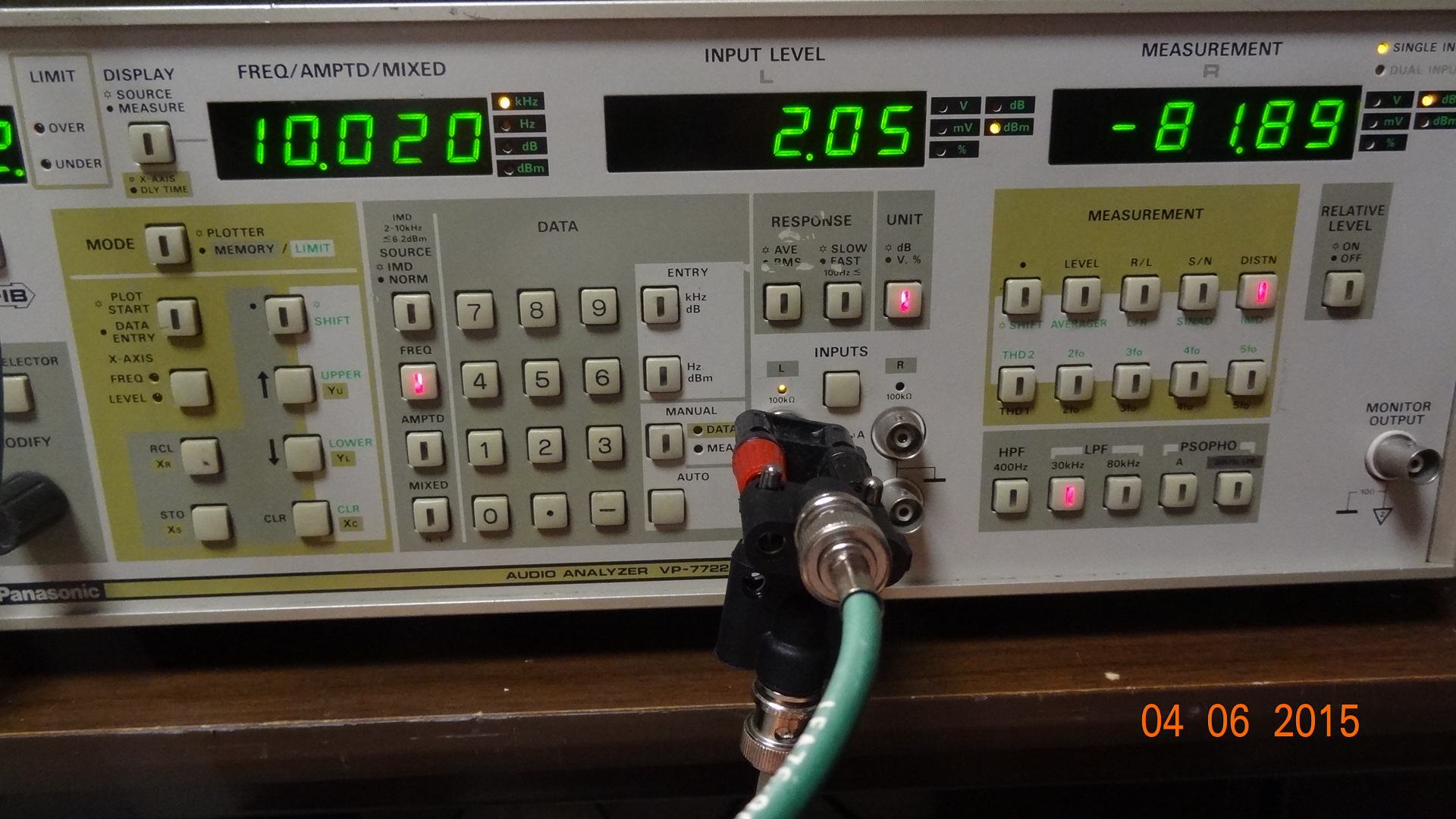

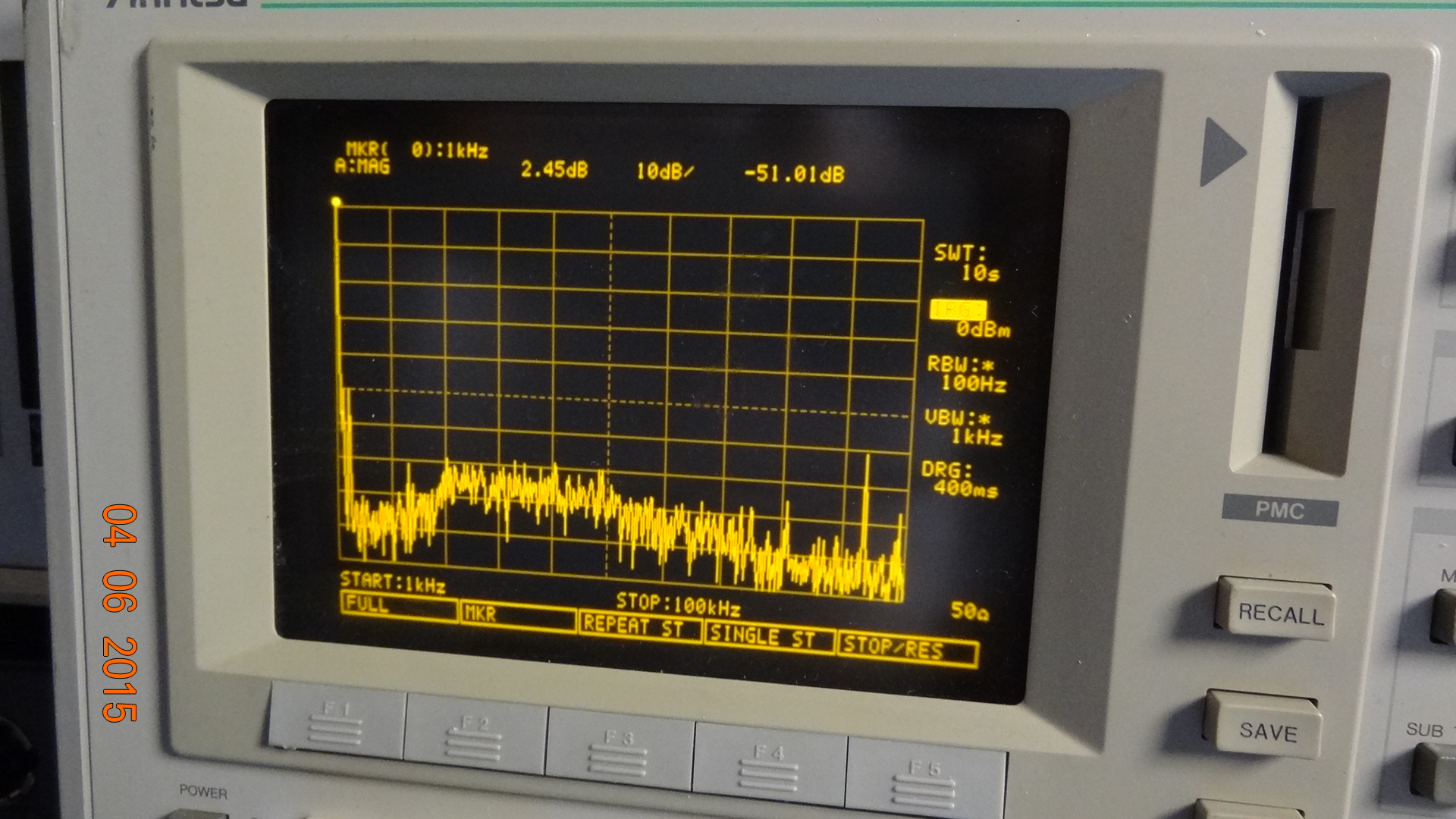

real CD s/n.
Some measured CD S/N info -- I recorded some ultra pure sine wave freqs onto CD then played that CD back - using same transport - into distortion analyzer and got these results which are not discussed in the specs. Note: This is a machine designed for Mastering (ML-9600). ).
The noise started rising above 1KHz at a constant slope of about 6dB per octave started at -88dB (30KHz BW) to -70dB. At >20 KHz the out of band noise jumped up further. In actual recording, the record level would be lower and thus worse S/N. Also, a spike at 93KHz... might be from smps being used.
Seems it could use some out of band filtering to prevent IM.
