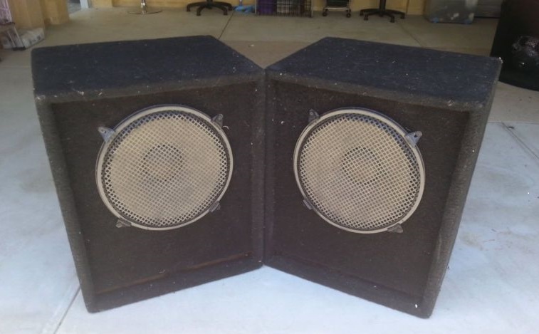

I just snagged these for $60.00 from an ex DJ....''Towtallee aaawessome basss mate"
Aus made 15" Lorantz (JBL 2235 copy) in reasonably cubic enclosure with 3" deep slotted port along bottom edge, no internal damping.
I will use these as speaker stands for the Behringer active 8"' two ways.
Fun times ahead. 😎

My new boxes internal volume (not subtracting woofer volume) is 137L.....internal 630Hx520Wx420D, 17mm good plywood, carpet on the outside. 😎
No doubt they will require tweaking, but they are a good starting point for proper bottom end, and who could refuse the price ....$60.00 :rofl:
I am running an Edirol UA-25ex USB sound card XLR out feeding the Behringers which have switchable low cut.
I just now confirmed that the Edirol optical out will feed my DEQ2496 which can then feed any stereo amp I feel like trying...no mono bass for me.
The DEQ provides a wealth of processing types to help in getting the subs to have any hope of integrating well....parametric, graphic, dynamics, width, delay etc.
