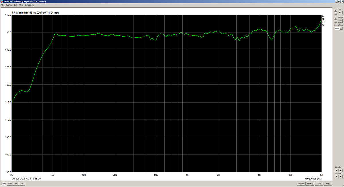

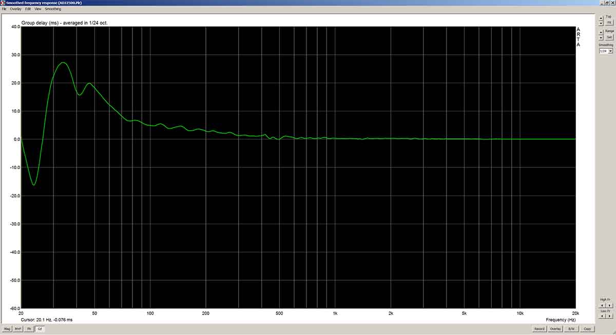

Every loudspeaker is a high pass filter, minimum phase, with an associated phase shift of 180 degrees for closed, and 360 for vented enclosures (half of that in the region where it actually produces sound). Hilbert transform and all that. In the context of factual learnings of Netherlands for benefit of glorious mister Marsh, please have a quick look at this anechoic measurement of a vented speaker.
20 mS @ 50 Hz.
20 mS @ 50 Hz.

It is the room of the Technical University Delft and they don't know 😀.
They used to have an audio group at the technical physics department, but nowadays only the anechoic room is left with a techie to open the door; it is just some left over infrastructure that can be rented by Dutch companies. I didn't measure it, but it must be about >10m in each direction, with man sized glass fiber wedges. I doubt it is true at 50Hz, but measurements don't show signs of standing waves even at that frequency, see the FR of the same measurement from which the GD was derived.
It's the wedge size mainly. And the wedges have to get really big. Of course you have to have a big room to accommodate the wedges. At some point you pretty much have to go outside.
A writer recently argued about some bass characteristic of the (in)famous Yamaha NS-10. His preconceptions were allegedly confirmed by anechoic measurements, but the problem was he believed chamber data that was well below the chamber cutoff. It has become an embarrassment, sadly, exacerbated by a stubborn streak.

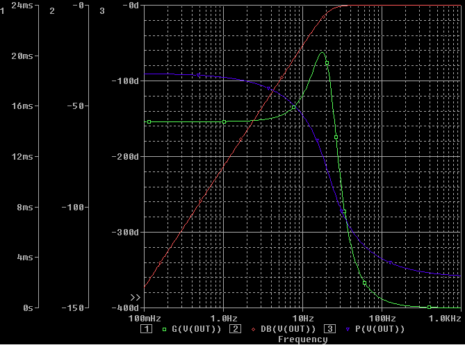

Maybe in the KHz range, but at 20Hz? It doesn't make any sense. Please come up with an authoritative reference about this.
Attached is the gain (red), phase (blue) and group delay (green) of a 3rd order Sallen-Key high pass filter, tuned at some 18Hz. Group delay is one order of magnitude higher than your target.
