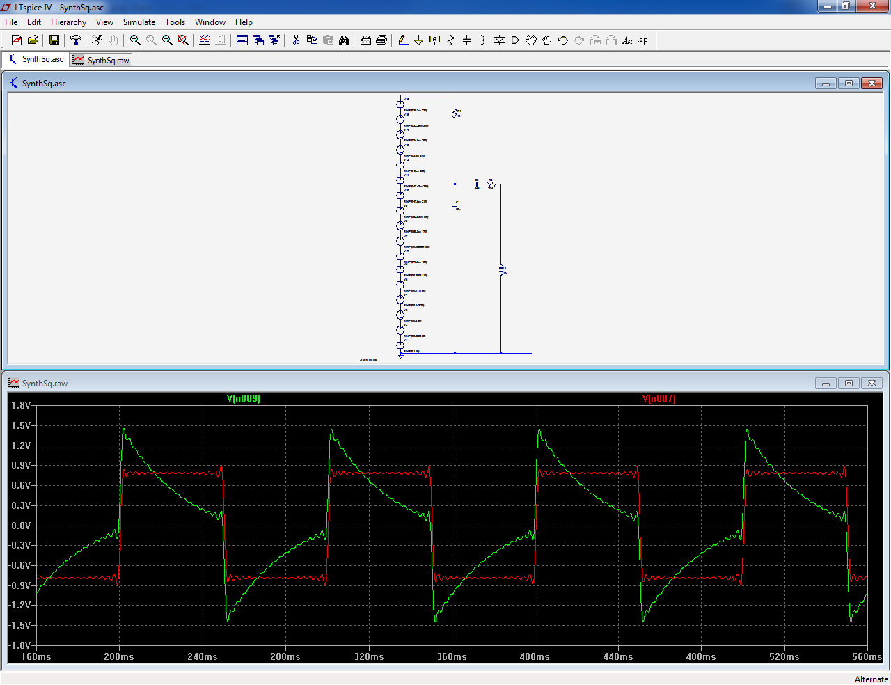

I dont see any problem with this:Transients are the same, and there is no musical instruments below 16Hz (organ) or 42Hz (bass guitar).Graphically, the answer is pretty obvious:
this how a synthesized, band limited (for phase accuracy) 10Hz square wave looks like before and after a 10Hz 2nd order HPF filter (Q=0.5).

what produces a 10Hz square wave in music?
A square wave at f tells you at a glance about the response from f/10 to 10f. Changes are linear distortion.

About 37 years ago, while working with HK as a design consultant, I tried adding the extra roll-off to an analog simulation of the tone arm resonance. Then with a step function or low frequency square wave as a drive signal, I looked at the results on an oscilloscope. Adding the extra 6 dB/oct. rolloff always made more phase shift, and so degenerated the transient response, no matter how flat it made the overall bass response.
Today, a SPICE simulation would show the same thing.
This could explain rather neatly why the vast majority of subsonic filters are first order, least added phase shift added.
Not to mention the fact that they are also the least expensive filters, which suits the industry wonderfully.
This one simulates an ideal HPF with constant group delay by turning off the 10Hz source in the 3.3Hz filter case. To be compared with the previously shown physical filter: they are quite different.I dont see any problem with this:Transients are the same, and there is no musical instruments below 16Hz (organ) or 42Hz (bass guitar).

It would be equivalent for a 30Hz waveform filtered at 10Hz. Even a 60Hz waveform would still be affected.

If a 20Hz rolloff is too frightening to see (in the time domain) then a 20Hz antiphase filter may be less frightening as when viewed in mono it does nothing at all. Few LPs have any 20Hz stereo information, as the studio has already cross-mixed the channels to make cutting easier. The phono preamp is then throwing away things which were never there, apart from warps.
