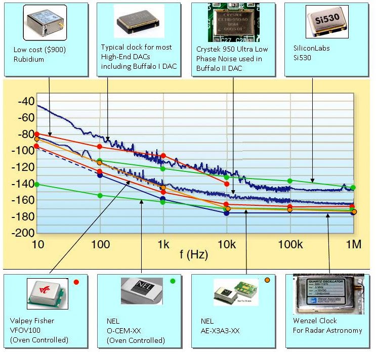

It doesn't have 10MHz
Yes, it doesn’t. (*)
I read that you abandoned the idea, this is the good news.
Top notch modern Cesium frequency standards offer at their 10MHz output SSB phase noise worse than most of the clocks you showed on your post #68534
Exctract from Microsemi 5071A specs
SSB Phase Noise 10 MHz :
1Hz - 100dBc
10 Hz - 130dBc
100Hz - 145dBc
1000Hz - 150dBc
10000Hz - 154dBc
100000Hz - 154dBc
Extract from an older Datum FTS 4040A specs
1Hz - 99dBc
10 Hz - 130dBc
100Hz - 140dBc
1000Hz - 150dBc
10000Hz - 150dBc
100000Hz - 150dBc
George
(*). You were interested on a used one. HP6061 is the (only?) one ending on e-bay. I was confident though that you would have focused on the important issues.

I do have a rubidium clock. Fairly fast to get a lock in the PLL locked crystal oscillator included. But phase noise is higher than my best reference oscillators. But I just couldn't pass up the chance to get a piece of equipment that used to be almost unobtainable.
More than a decade ago, during the investigation phase of purchasing a Caesium clock for disseminating time in a cal lab, tight budget turned us to Rubidium clock. In both cases phase noise was questioned (it would be very convenient for us if we could double the utilization of this unit as a local reference standard for frequency calibrations. We decided that we shouldn't).
But Richard may ask the seller for the phase noise of this Rubidium clock generator
10 000M Ultra Precision Low Noise RB Word Rubidium Atomic Clock Generator HiFi | eBay
and compare to some of these
High Reliability Ruggedized Oscillators | Time & Frequency References | Timing & Synchronization Systems | Products
Now there are some that can be programmed to be used as a CD clock. But a good crystal oscillator should be better in that application.
That was the clear message in jxc post!
