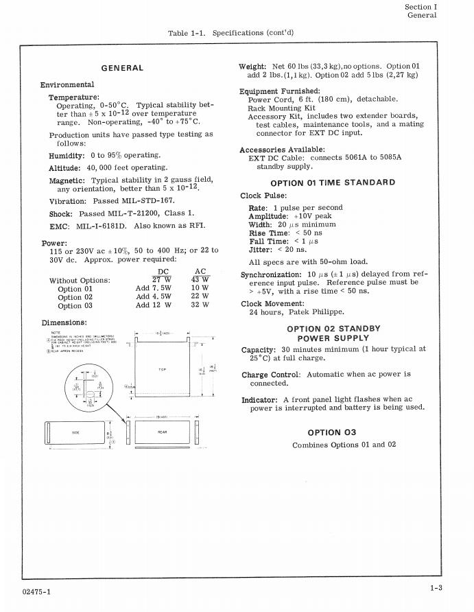

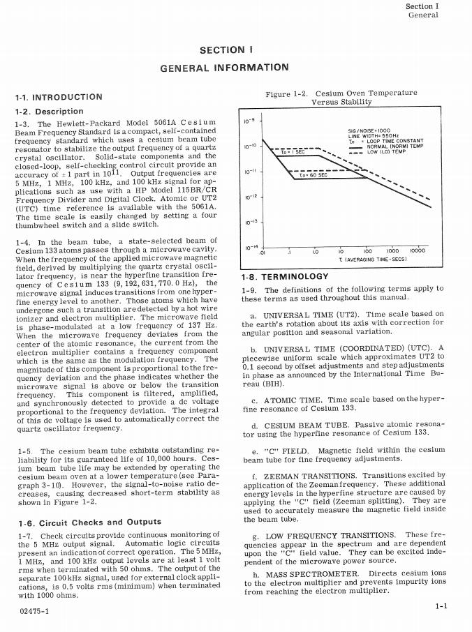

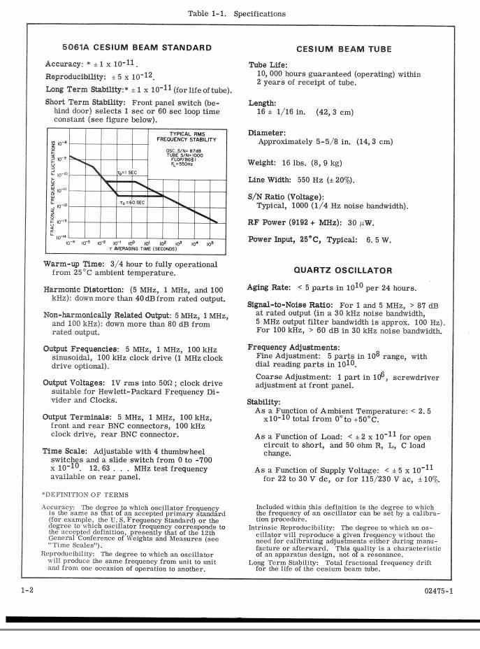

Anyone with real knowledge about the jitter on (used) commercial Cesium time standards (with a 10MHz output)?
Richard
As jxc wrote
Confirmation: Look at NIST page, Time and Frequency Measurements
Characterization of Atomic Frequency Standards (77110C)
oscillator
Allan variance - Wikipedia, the free encyclopedia
http://www.cs.cmu.edu/~dga/time/5061/5061A_ops_and_schematics.pdf
Index of /time-freq/plots
