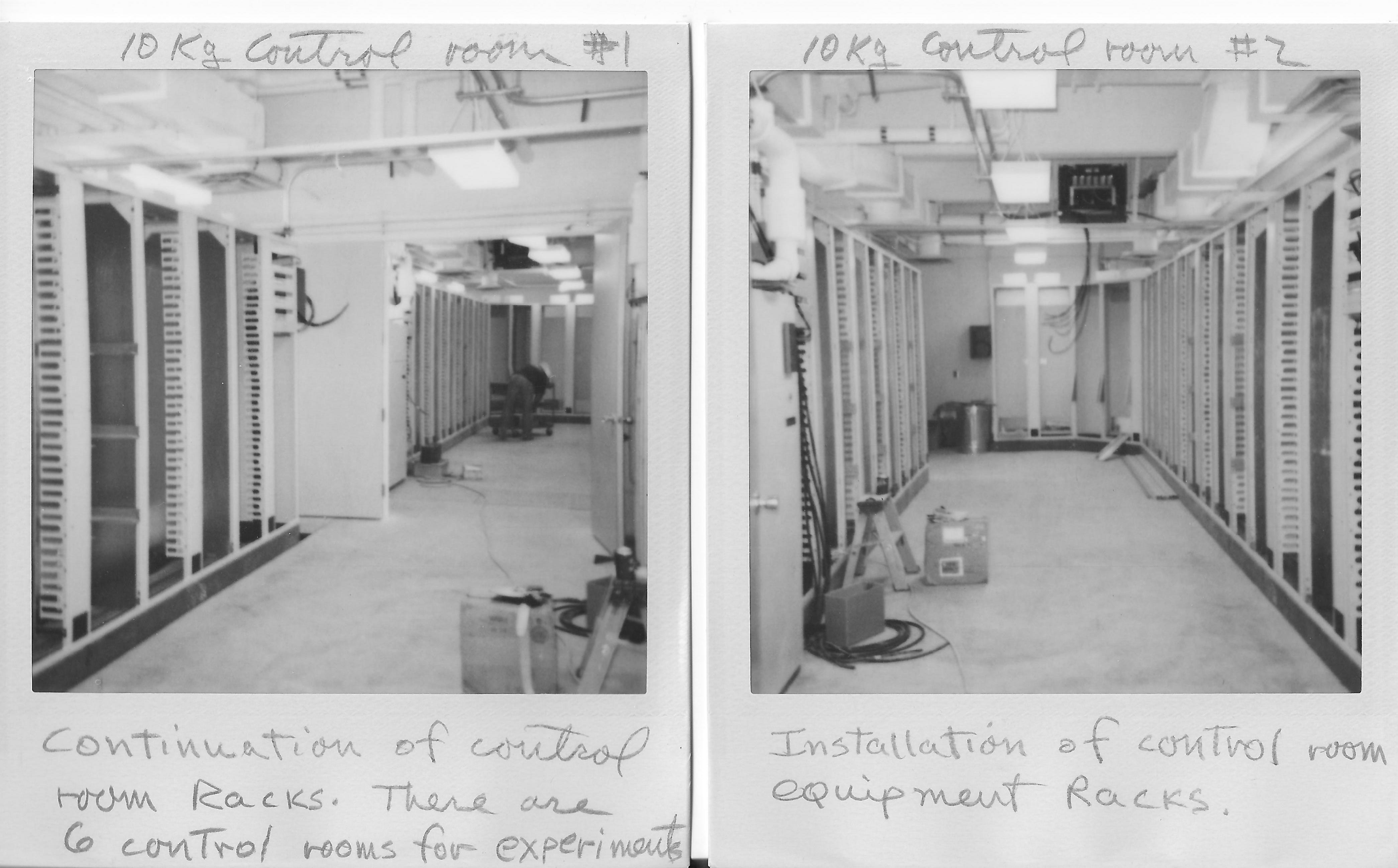

Here are two rooms out of 6 that house diagnostics and controls for 6 experimental chambers (HE weapons). The big black thing hanging from the ceiling is a 10KVA isolation transformer to power the equipment in the racks. It was my responsibility as Sr EE Technical coordinator to coordinate the design/development and construction for the electronics and power for the experimental areas in the HEAF facility. That included system grounding.
Same for other projects --- three phase? Three-phase isolation transformers.
THx-RNMarsh

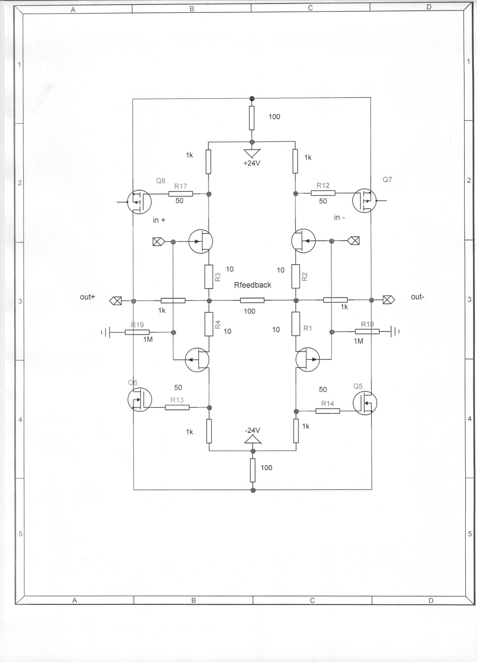

If we are going to discuss a 4Q circuit, let's start with something more complete, but still simple:
I haven't tried it with all FETs yet, but doing this with a cross-coupling (i.e., use the sources of the bottom pair to drive the gates of the opposite top pair) using pFETs and tubes got me better than -100dB IM (19/20kHz) at 1.3V out and CMR that was high and nearly constant across the audio bandwidth. There's a lot of power in balanced 4Q indeed.
