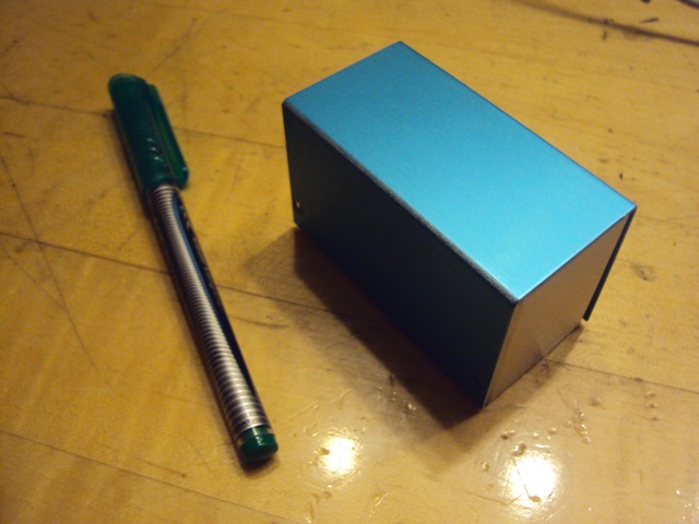

I will put the caps and switches in this little aluminum box and ground it. Maybe that helps. It also hides the components from view. That may be good for a less biased outcome.

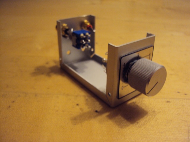

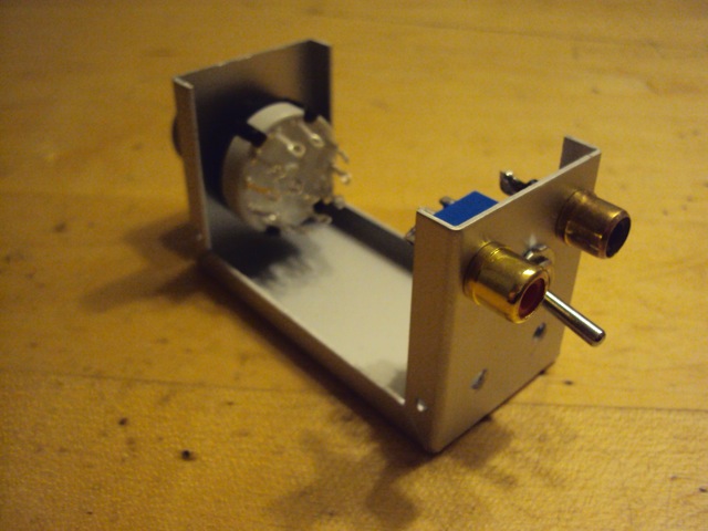

Besides i am working on the little cap switchbox and this is how far i got.
Let me state right away that my goal is not to find an absolue ranking and the results are only valid in the context of my own system.
I will ony measure the value of the components and will try to match them to better then 5%. So no measurements of distortion, DA or anything else will be made before the listening test. After the subjective and informal listening test it will be interesting to measure for example the "worsed" against the "best" if that brings out any differences on the bench.

I've built something similar, the difference being that the first two switch positions are known (position 1, V-Cap teflon; position 2, Radio Shack electrolytic) and the remaining 12 are randomized. All silver wiring, Cinema Engineering switch, gold-plated nylon dielectric RCA jacks. Hours of fun for your friends.
