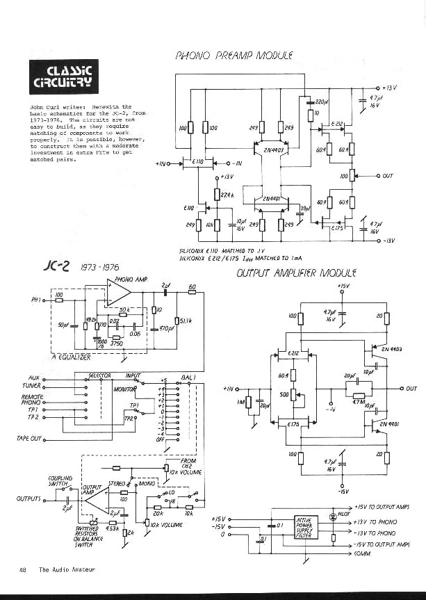

This design was done in 1973, or 42 years ago. Both feedback and coupling caps were used. Today, we would direct couple, remove many of the caps, servo, AND save money. Any harm in that?
