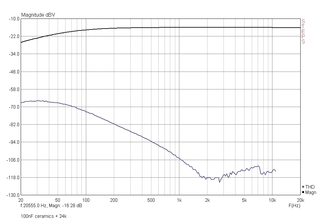

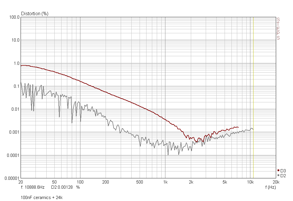

-105DB ? Ok, i think we can afford one (and only one) in a system. (In a servo, as example ;-)
Yes.

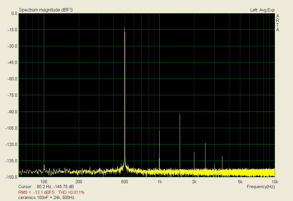

Fundamental is -10.7dB (you need to read fundamental amplitude), so it is -95dB in fact. Still good. Getting worse with lower frequency, as voltage across the cap is rising.
