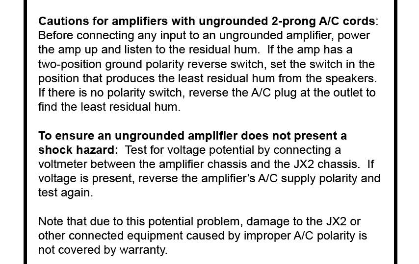

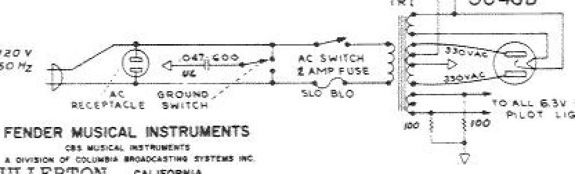

>We have known about this since the vacuum tube days
>and unpolarized AC line plugs (2 prong).
>Why this happened was always a mystery to me.
It's something to do with the interaction of the chassis
with the ' ground field ' (for lack of a better term)
If a little of the hot side of the mains is on the chassis
it causes hum (as well as some potential for hazard)
Guitar amps actually have a switch to reverse polarity.
