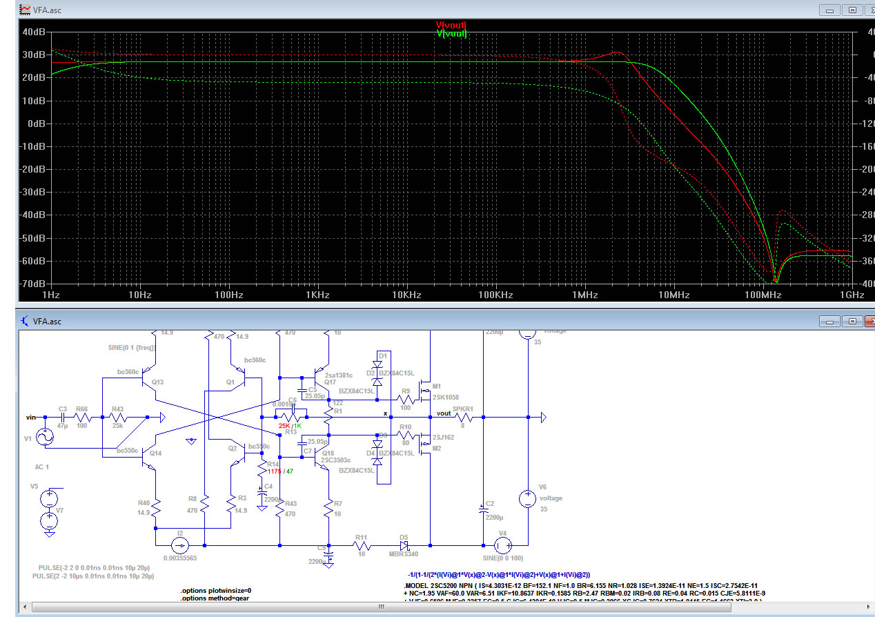

Ok, if my "Extraordinary claims" was what i said about feedback impedance influence on the closed loop bandwidth, a quick'n dirty simulation on a VFA .
If you agree that 1175/(1175+25000) = 47/(47+1000), you will agree the feedback ratio is the same. And as everything else is unchanged, open loop bandwidth unchanged.
I just edited the two simulations with a picture editor to make-it in a single image easier to read.
Is this not enough for this kindergarten ?
Oh,yes, it is not in your books.
