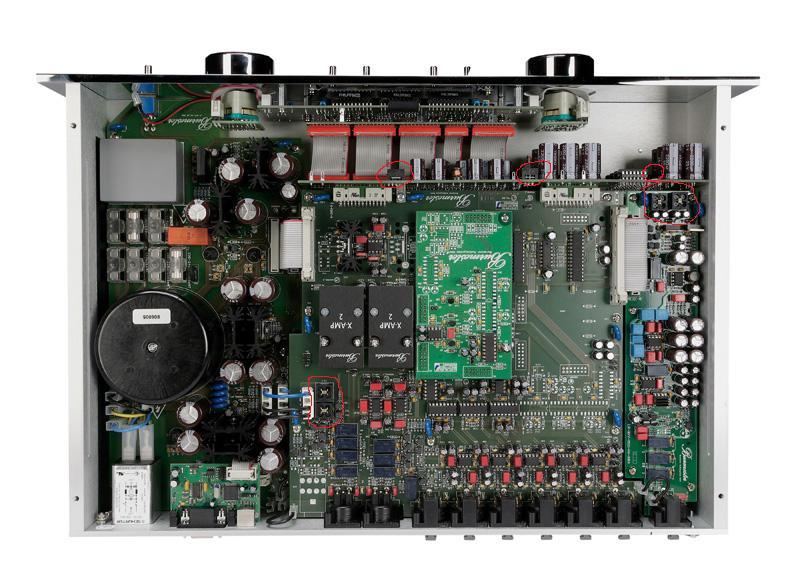

ES
the aforementioned gear
A pic is worth 1K words, total of 10, including the 6 on the PS board.
(the slick 069 CD player has them as well, also 6 of the BNX on the PS board. Same setup in the 808-MK5, 070, etc.)
