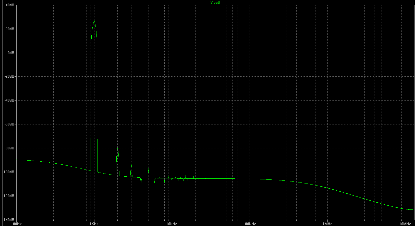

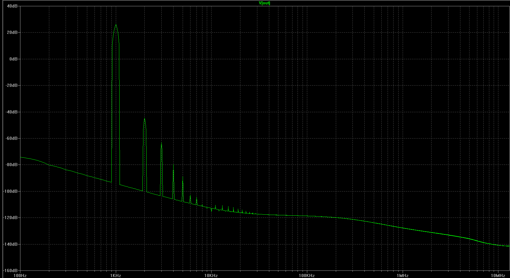

Ok, so what amp will sound better?
They are both CFB with same OPS but first have single ended gain stage, and second have complementary gain stage. They both have 40dB of global feedback and fundamental F is 1KHz +27dB.
