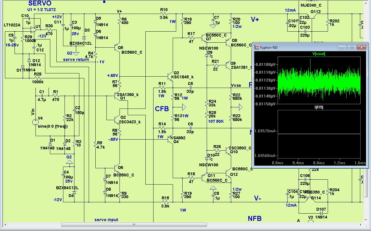

Not only "NOT evil", but as it help us to get rid of DC offset adjustments, with all the evils of the adjustable potentiometers, it save time (money) and bring a better reliability over the long term.
In fact, the only annoyance of servos is the need of +-12V DC rails to power the IC.
No need to servo or use DC blocking caps in the feedback path of a CFA. Both the nx and sx amps are DC coupled and the drift and offset are exemplary. With the diamond buffer you have 1 st order cancellation of the delta Vbe so imeadiately are into low drift territory. Close physical proximity also helps. I use an offset adjustment pot - but with a servo you need a power supply, decoupling not mention an opamp as well so the pot is hardly excessive in that context.

I can screw up , and my servo "saves me" ,
Any devices for Q1-4 , you can get real "sloppy" on this circuit.
I Modifed one of my creations - listening to the (below) "abomination".
For a true entry level build , it just works. My last CFA , BTW.
PS - having the same semi's for Q1-4 - almost no thermal drift.
Output slowly cycles +/- .1mv (not as good as the simulation).
R6/9 are different - running Q2 20% more Ic than Q1 for laughs ! 😀
If you look to the diamond VSSA i published, you will find some advantages.
In the original VSSA, there is some additional gain provided by the input stage. That was clever. It helps to reduce open loop distortion, while keeping the schematic as simple as possible. The cap increase the feedback at DC to 100%. The drift at the output will be only the one of the input stage.
The servo i suggested brings some obvious advantages, specially on an industrial point of view, by suppressing the need of any fine tuning of the DC offset. And you can set its gain to go even further, decreasing the offset, simplifying the temperature coupling of the input devices.
Yes, it adds complexity, but, once the board is designed, it is only few components more to add to the circuit, and their overall price and size are lower than the original Lytic CAPs. Too It dont brings audible evils of those awful devices, with a relatively short life, full of DA etc. ;-)
Too, there is two advantages to set the input filter were i did. It kills the natural instability at very HF of the diamond and it makes the FC of the input filter not sensitive to the source impedance.
About powering tthe IC of the servo, yes it need an effort to power-it. But you can set an additional +-15V power supply that you can share with a protection circuit, like the one in my signature. And even build the preamplifier in the box, powered by the same PSU...

I think servos are the way to go and that the need for an offset pot is a disadvantage, not to mention the necessary matching of transistors. An amplifier with a given gain, on the order of 20-30, when dc coupled, will have about the same offset without a pot, for a given degree of input transistor matching, be it CFA or VFA. A CFA has no fundamental matching benefit over a VFA. Moreover, a VFA built with a single monolithic NPN dual matched pair can provide very good offset performance.
I prefer a power amplifier to have less than 20mV offset at the output, and the dc servo is the best way to accomplish this without an offset pot or a lot of transistor matching (if you don't want to use a capacitor in the feedback network).
A good dc servo is quite simple and takes up very little board space, and is probably less expensive than an good-quality dc offset trim pot.

Instead of using terms like "fairy tails" better to *demonstrate* were i'm technically incorrect (if i was).
I don't said anything strange about caps neither. Lytics are not totally transparent, everybody noticed-it. And you have to change them, let say, all the 10 years ?
A servo just allow to use film caps instead. Better and long lasting.
The main negative point with a servo is the output noise of the IC.. ahah, reduced by -54dB in my example, go figure !
And all my other arguments are valid, including the time to tunne DC and evils of the trim pots with years, oxidation etc.
