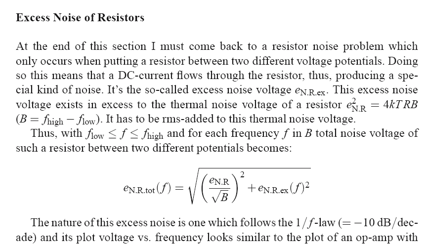

Except at 0 DC current there is no excess noise no luck needed only physics. Please find me some 56Meg Dale RN55's.

That's not my application. I use 5G myself for that. Even at 5G the dominant noise is the RC of the bias resistor and capsule capacitance (20dB/decade) while the excess noise (if it existed) would be 10dB/decade. Even another reason that it does not matter.

On the other end of the scale p.172 Fig. 9-1 of M&F shows the increase of excess noise across a 10K resistor with an NI of 0 dB and 10V DC across it. The curve tends to get worse than ideal below 3KHz or so. When is this important? Perhaps with vacuum tube plate resistors and some input resistors biased with DC which often happens with single power supply operation. Still, I must agree with Scott, that many newer ways of circuit design have taken DC from the most important noise contributing resistors, although I might note that my second stage biasing and servo resistors have about 15v DC across them and it might be a potential noise contribution. It certainly would make the actual noise greater than the nominal resistor value and therefore a potential problem. However, I already use pretty good resistors, but someone trying to copy the circuit might use much cheaper ones and get into trouble. Interesting, I never had to think about that, because I stopped using high NI resistors, many decades ago.
