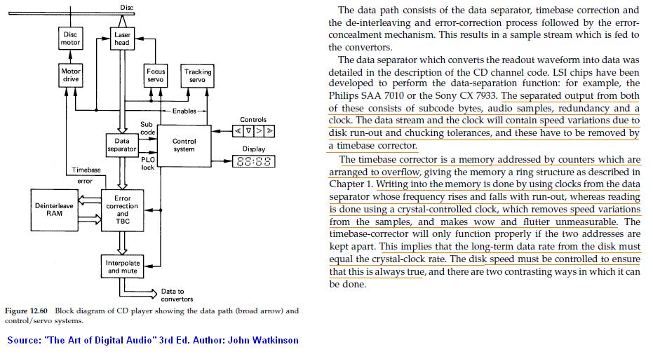

You have to use a PLL in a CD player! The clock is derived from the data on the disc. In theory you could vary the speed of the disc to get the data to match your clock, but inertia, out of roundness etc prevent this approach.
Jeez... This is EXACTLY how CD players work! One varies the rotational rate of CD. DAC is clocked by the crystal oscillator.
Don't CD players have a small digital buffer to hold samples read from the CD and reclock them to the DAC clock?
In CDP system, disc spin motor speed is controlled in order to keep data buffer half full on average.
The PLL is used to derive the disc spin control voltage.
Audio data is clocked out of the buffer at crystal oscillator determined rate.
The crystal oscillator also provides clock for DAC output stage.
Little by little…
George
