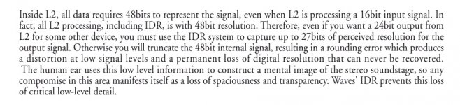

I saw no need for dither on 24b as I showed at -90. This morning, in an email, I asked Bob Speer of CD Mastering Services "--- dither is used only when reducing the word length. .... for 24/96 HD dither is not used" for clients such as HDTracks and others for hiRes downloads.
I can quote numerous other mastering engineers who will say the opposite.
Read a couple of posts by Bob Katz here, for example:
When reducing bitdepth from 64-bit to 24-bit in ASIO, does JRiver....
I hope he doesn't need an introduction 😉
Also, take a look at this excerpt from Waves L2 hardware box manual. IDR is their dithering/noise shaping algorithm.
