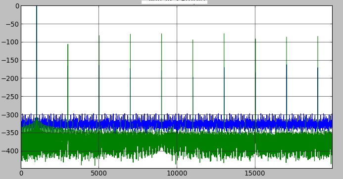

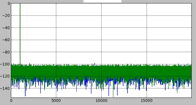

DNR again. These plots are for -80db full scale at 24bits and 32bit floating point. Remember this is just the DNR possibility of a particular numeric representation, a purely math problem. The second undithered, yes the numerical noise floor of 64bit double precision math is -300dB or so. The first is dithered at 1 LSB with a triangular probability distribution, what you actually can save as a 24bit file. I still see nothing that indicates more bits has any benefit at all.
