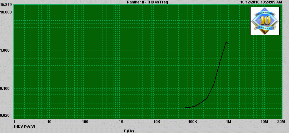

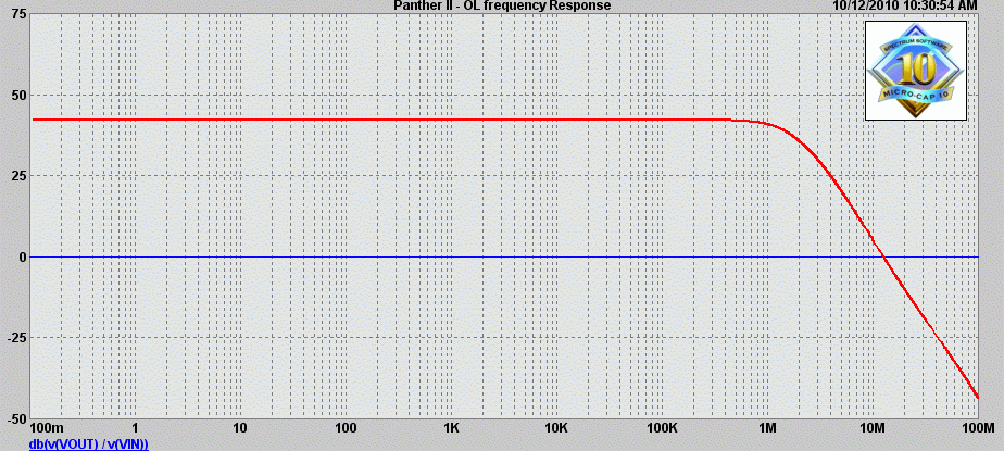

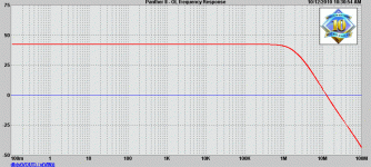

When you design an amp, what OL BW goal do you set out for?
Thinking about THD vs Freq curve flatness and OL BW, this amp of mine, is a dream (yes, simulation "only"):
/Ingemar

The one on the left looks better to me (due to less high-order muck). There's something fishy about those plots, though.... 😕 Hopefully you're going to give us an idea of the circuit used and the changes made?

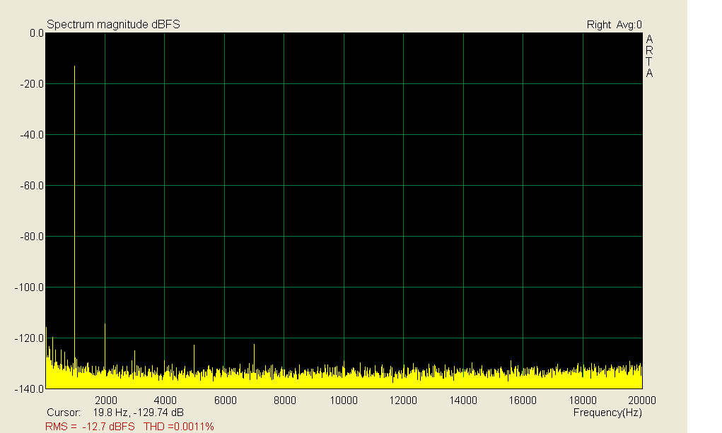

"Is there a way to achieve that without bringing back the >8th harmonics?"
Yes, there is. This is the same circuit, 25W/4ohm (as before), close to clipping. If we go down to 100mW, distortion is same, but only 2nd and 3rd.
