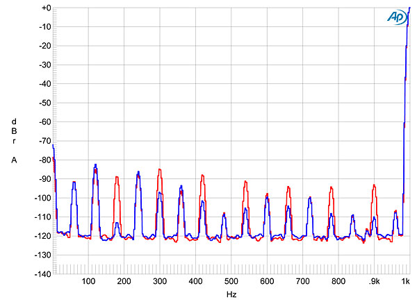

The "Big Guys" should learn first how to handle mains related spectral components and their intermodulation in audio band
Fig.3 Constellation Performance Centaur, spectrum of 1kHz sinewave, DC–1kHz, at 1W into 8 ohms, samples 1101130901 (blue) and 1101131902 (red) (linear frequency scale).
before starting to write here these fairy tales on 24-bit insufficiency.
Non-harmonic distortion is the key to sound differences.
