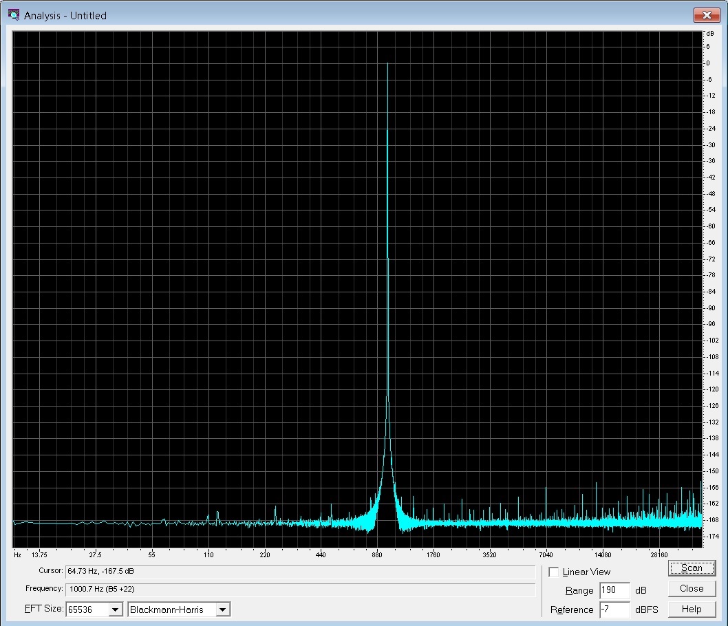

How is -160dB noise floor possible when 32bit float has 24bit mantissa?
We're talking about two different things. This is a 32 bit sine wave at about 1Hz (96000/65536) per FFT bin. The spurs are actually systematic errors in the standard math function for sine.
Yes, I took it by 'noise floor' you meant in the audible band.
So there the noise looks to be around -170dB in a 1.5Hz band which integrates out to -125dB or about 21bits.
