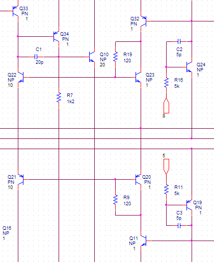

LT1166; 1uF cap
According to syn08's (reverse engineered) schematic there are a few a compensating caps (see pic below). However, preliminary sims suggest that these caps don't do their job very well.
BTW, there's another thing that isn't explained or fully covered by the data sheet: the product of the currents of the top and bottom power transistors is NOT held constant, rather it varies linear with the absolute temperature.

Hi Bob & Klaus,
Generally, I fully agree with that. However there might be one exception: If BJTs are used (having an exponential Ic/Vbe x-fer function) and if the value of Re is sufficiently low, then -at a constant bias voltage and temperature- the product of the currents of the top and bottom power transistors is already constant. So in this case a 1uF cap across the bias generator is not that detrimental.
edit: I'm not sure whether this also applies to syn08's amp.
Edmond.
1uF cap across pins 1 and 4:
