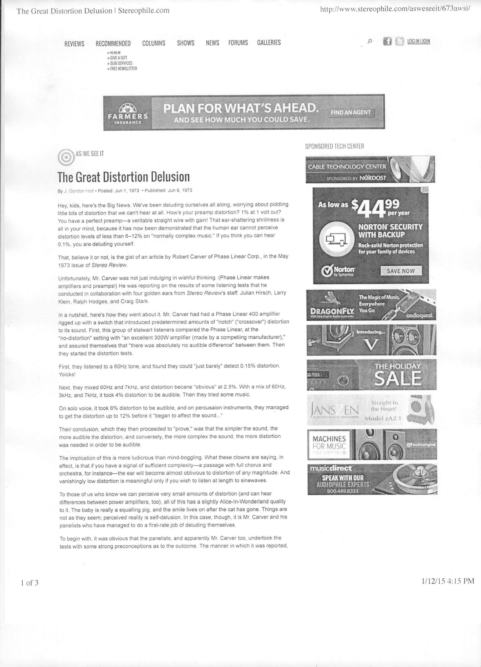

I mentioned the carver test - the GEB claimed they could pick out one amplifier from another. Bob Carver proved they could not even in an uncontrolled tests. So, under controlled tests most subjects fail, and when we have an uncontrolled test but with a basic level of 'no peaking allowed' they also fail . . .

Carver also proved that large quantities of xover distortion in amps was not audible.
Where and when did he do this?

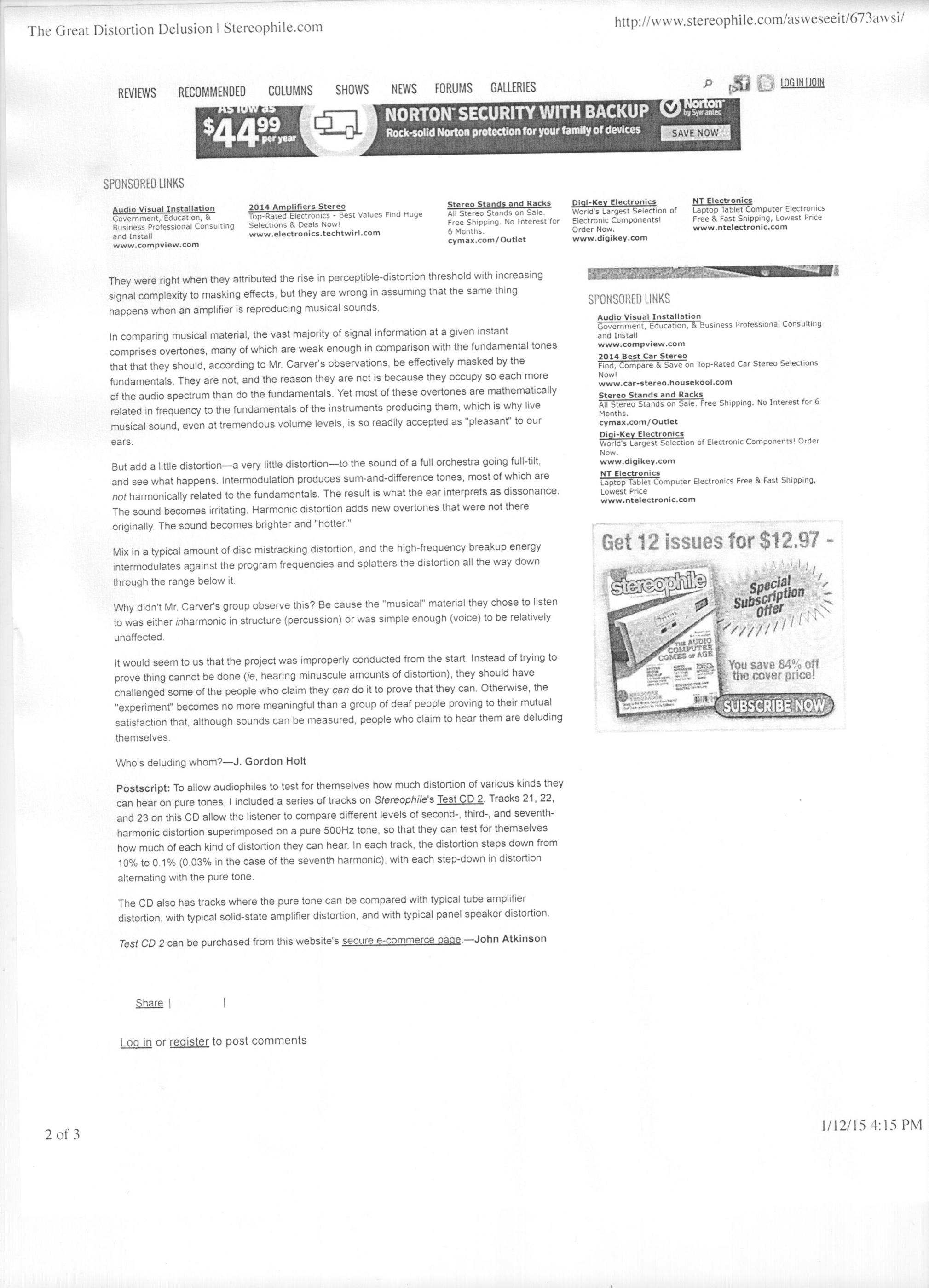

Here is the Carver test as examined by Gordon Holt.
Thanks, John! Any follow ups on this that you're aware of?
I find it amusing that to allow his readers to test audibility, for a test signal Atkinson chose... a pure sine wave.
The SR results implied that a single sine wave was the MOST SENSITIVE, so what is the problem?
That's probably right and it's quite interesting. Why does our sensitivity to crossover distortion diminish with more complex signals like music? What are the implications of that?
