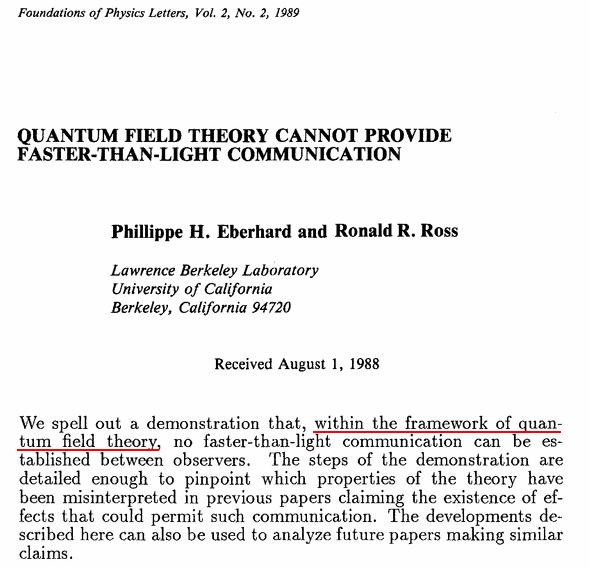

There is a paper by IIRC Phillipe Eberhard propositing that causality can never be violated, yes the argument goes on.
Scott
P.H. Eberhard and R.R. Ross were not generalizing
Quantum field theory cannot provide faster-than-light communication - Springer
yes it's equally non-intuitive either way but the distinction is important.
The debate lasts for years
Backward Causation (Stanford Encyclopedia of Philosophy)
"A general notion of backward causation raises two sets of questions: those concerning conceptual problems and those that relate to empirical or physical matters."

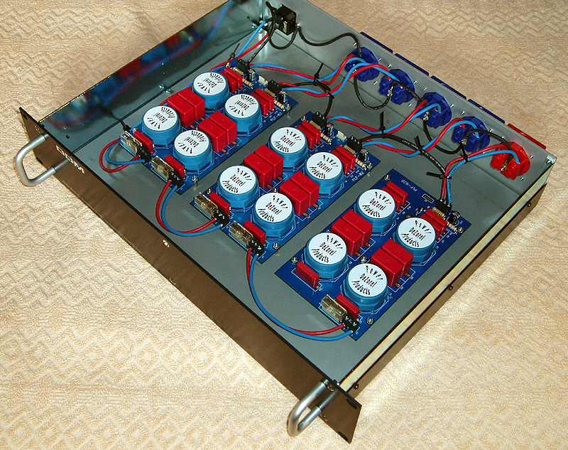

I start at just above the 50/60 Hz line, which I cannot touch if I want AC to remain AC as expected. It goes down about -2 dB at 1 kHz, and then progressively down to -60 dB at 20 kHz and onwards. AS most filters, it has a "comeback" at arounh 300-350 kHz and then decends from tha point onwards to a maximum of some -84 dB of suppression.
So far I have had problems with only one unit, so I kep thet one because I want to find out exactly why it behaves funny upon switch on, which means upon plugging the cable into the socket or the other side into its input IEC recepatcle. Sometimes spark appear and it's tripped the line 16A (at 220 VAC) fuse a few times. No obvious reason, but to me this is serious midbehaving. I reckon it ain't smarter than me, so I want to know what gives. Never before, never after that one sample. It's a great who done it police story.

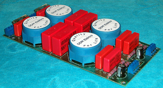

Below are the basic dual or super filter modules and a my top model with 6 parallel filters inside. I wasn't selling air, I wasn't.
Sounds like an arc mode. Once arcing occurs and the current reaches a certain threshold, it basically acts like a crowbar. GDT surge suppressors use this effect. When you plug it in and it sparks, the inductance of the socket wire resonates with the capacitors and can double the line voltage. After some series inductors the voltage can be boosted again by resonances if they fall in an unfortunate range.
One theory I have is that if an arc occurred, it may turn that power filter into a resonant oscillator, feeding the arc and keeping it alive rather than quenching naturally when the current drops low for long enough.
If so this could be tested by capturing the event on an oscilloscope and watching for oscillation. Capacitors which measure out of tolerance or significantly different from their original measurement would also be an indication.

Do you have the ability to do a "High Pot" test? This applies around 2500 volts for under 2 seconds to measure the resistance. It will show up insulation issues.
Biddle is the most popular of the tester manufacturers. I have some of their test gear that is probably more than 40 years old, works great, paid peanuts for it.
Indeed, I do advise it, however only under the provisio that you try before you buy, no blind purchases, Power line "cnditioners" come in right after the cables for the amount of BS and snake oil peddled to the masses.
Simon, this is something more insidious. Once connected, it works flawlessly and reliably. it's only the moment of switching on that's problematic. The filters have no ON/OFF switches, they are meant to be plugged in and forgotten, and I would always look with suspicion on any high power switch for sparks and other folly.
I should soon move into my old room and thus reclaim enough space to be able to take it apart and seriously investigate the matter. It's behaving as if something inside is in short ciruit, which of course all the caps initialy are, but they are not big enough to do this sort of thing on any regular level. I might have a suspect cap or two which passedthe initial operation test before being soldered in, but may have developed problems later. If so, I should be able to locate them relatvely easy, I'll simply disconnect filters 2 and 3, see what happens, if nothing than reconnect fiter 2 and see when do the problems start. I'll probably change the caps on the one causing the problem and that might be it. If not, I'll play the detective some more.
And no, I do not have the capability od passing 2.5 kV anywhere, nor are the cpacitors meant to go that high.
