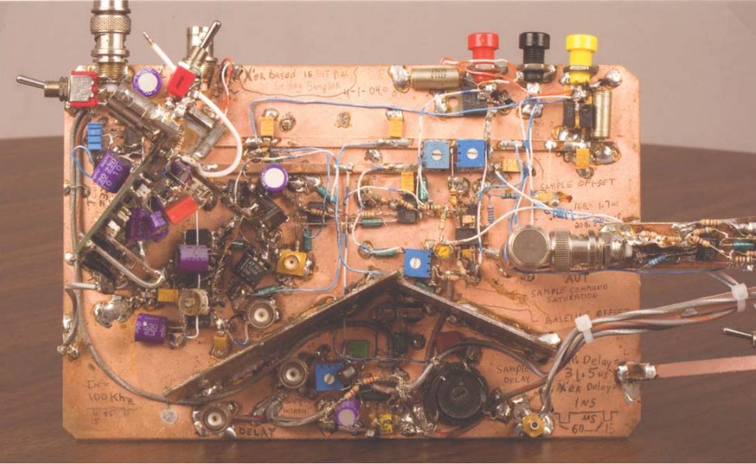

That looks like something by the great Jim Williams.

Looks like a Jim Williams (RIP) piece.
(He also did some pure 'Art' stuff - I think it was published in one of the Linear Tech apps books)
