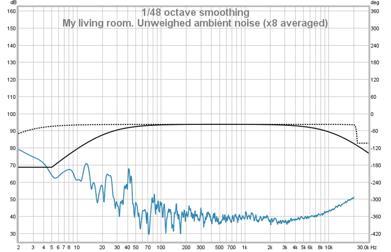

Even older folks are expected to be able to hear up to about 10-12 kHz, by which time any tweeter in any loudspeaker box must be doing its thing or the sound will be impaired, sort of like standard AM at best.
Dejan,
AM transmitted musical content spectrum is limited to 5kHz. FM to 15kHz.
If there are -consistently- higher frequencies than these amplified at the receiving side, they are harmonic and intermodulation distortion products (easily produced at the detector and/or the stereo decoder section).
I still can hear 10-12kHz but with some 26+dB loss (rel mid freq).:D
So a reasonable conclusion would be your listening environment is noisier than 26 dba.)
Let me try three guesses, your room is not that quiet, your room is not that quiet, your room is not that quiet.
Have you ever measured the noise level in your listening room?
Ed
26dBA is low noise number, very quiet room!

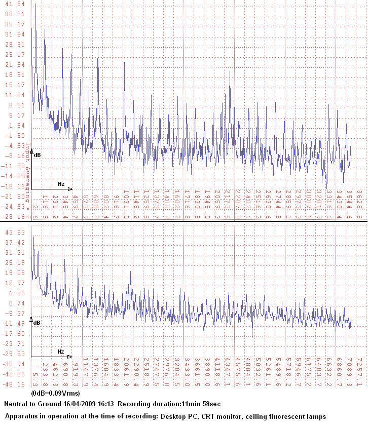

Re grid noise...
Monitoring the neutral to ground for some extended period of time, can provide enough evidence to anyone that any seconds or minutes long recording of grid line voltage is only a snapshot of the ugly reality and nothing else (just raw data as DF96 says).
Utility voltage is polluted a lot by other’s equipment and by our equipment as well. We have to live with it.

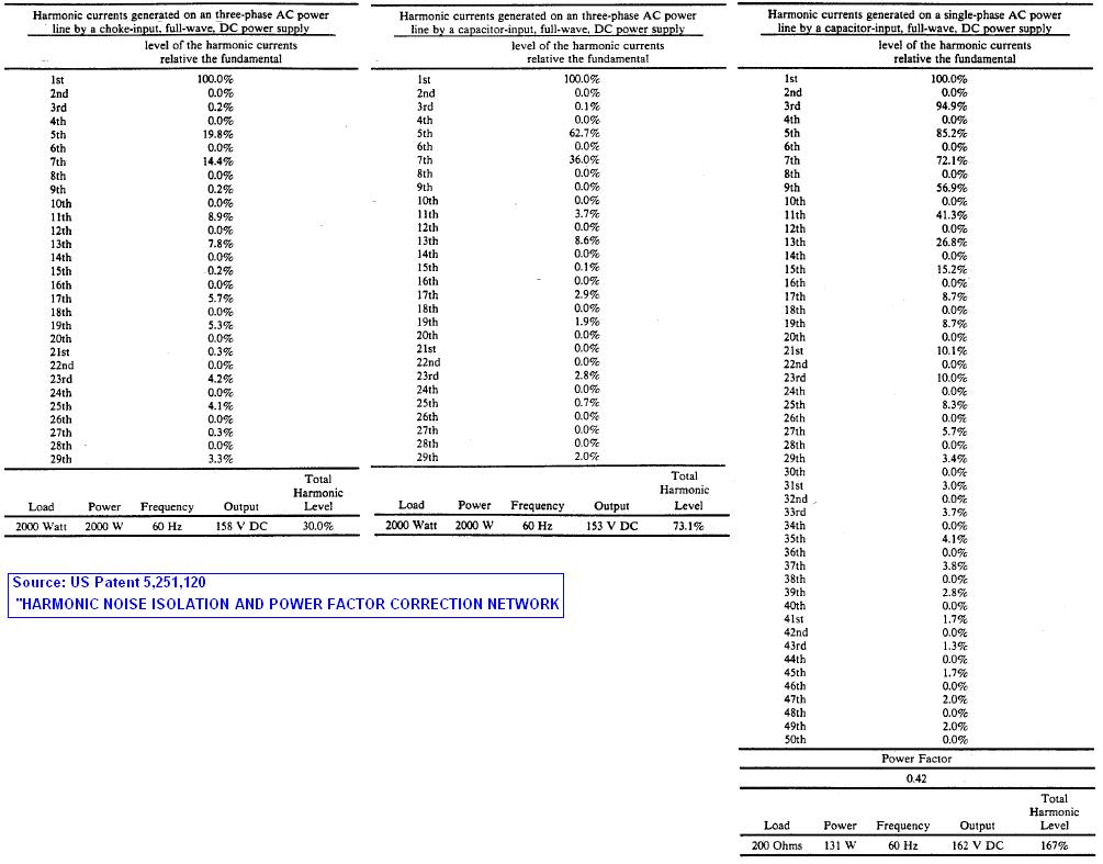

A chap called Cordell, who some believe knows a thing or two about amplifiers, had this to say about Power Supply Noise in a book:
The power supply rails in any amplifier are often corrupted by numerous sources of noise. These may include random noise and other noises like power supply ripple and EMI and program-dependent noise from the output stage. The power supply noise can get into the signal path as a result of the signal circuit’s limited power supply rejection ratio (PSRR).
So, sticking your head against the tweeter while all is dead quiet may not tell the full story ...
