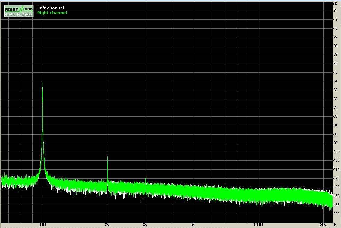

Intrinsic + cartridge distortion make products above 20kHz. Take a 16kHz test record and you will see 32kHz 2nd harmonic - always, with any cartridge.
That’s it.
2nd & 3rd with any cartridge when reading low modulation velocity tracks (att 1, 1kHz at -20dBu ).

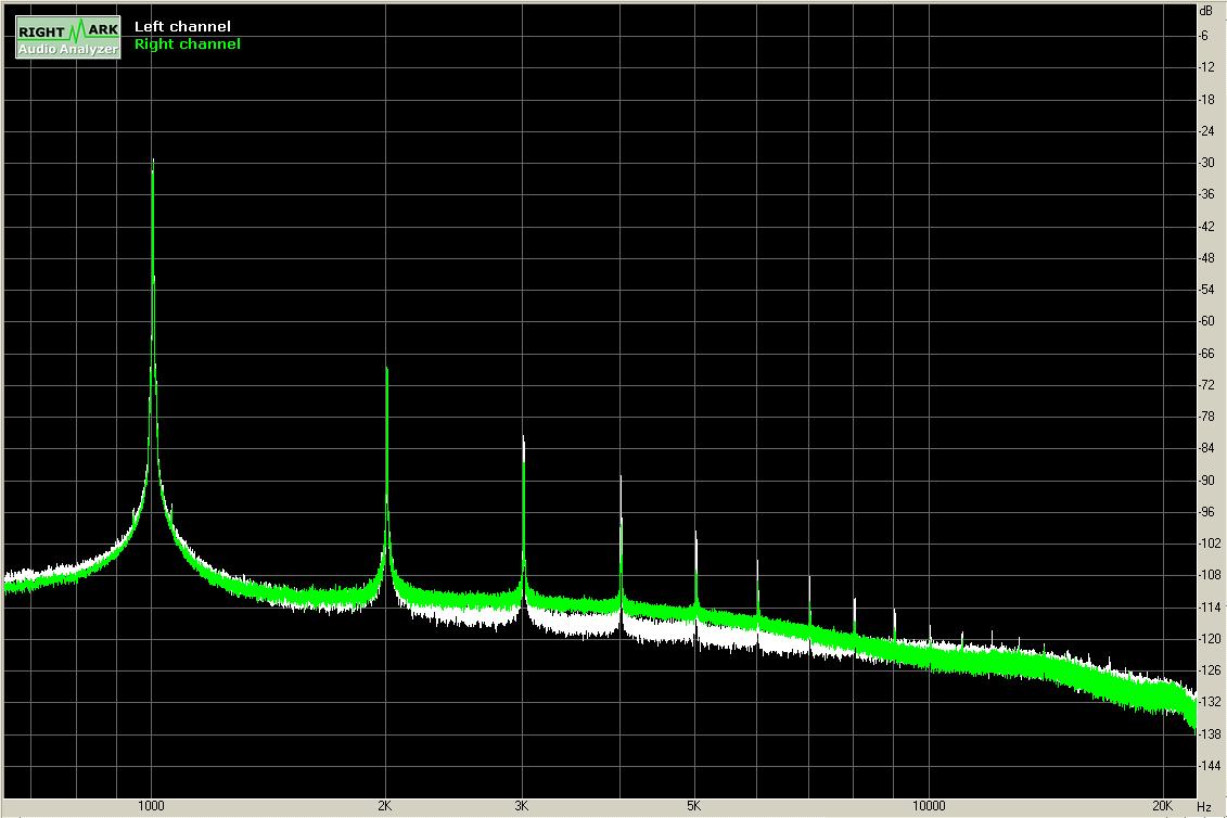

And when reading high mod velocity tracks, harmonic content goes beyond 10th (att 2, 1kHz at ref. 0dBu, i.e. 7cm/sec).

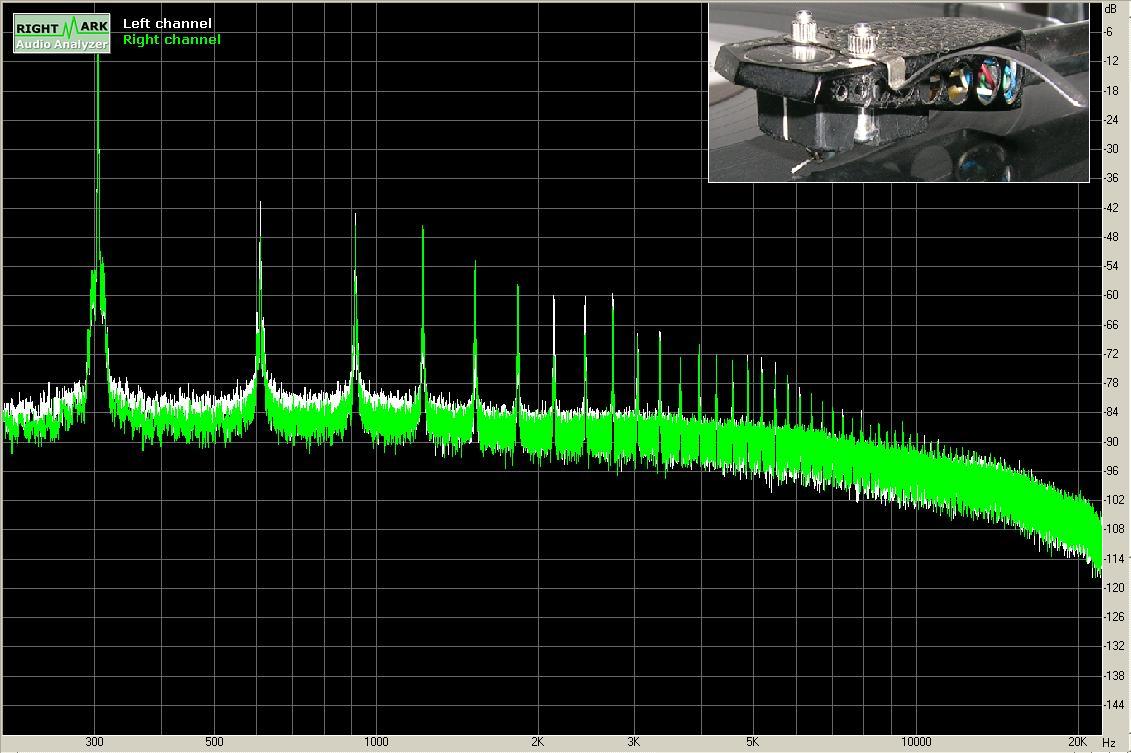

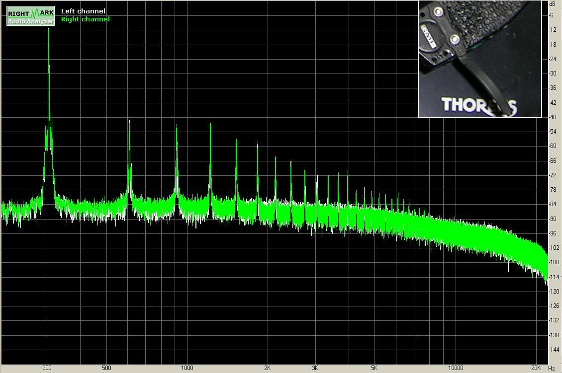

Plus variability among playback equipment can be tremendous. Every component on the TT adds to the signature of sound.
As an example, the following two freq spectrums (att 3, 4) represent the same test track (HFN Test LP Side 1 Track 9, 300Hz +18dB) played back through the same set-up.
The minor change that alters the spectrum is damping of the SME headshell’s handle, which has been covered with thermo-shrink tube .
