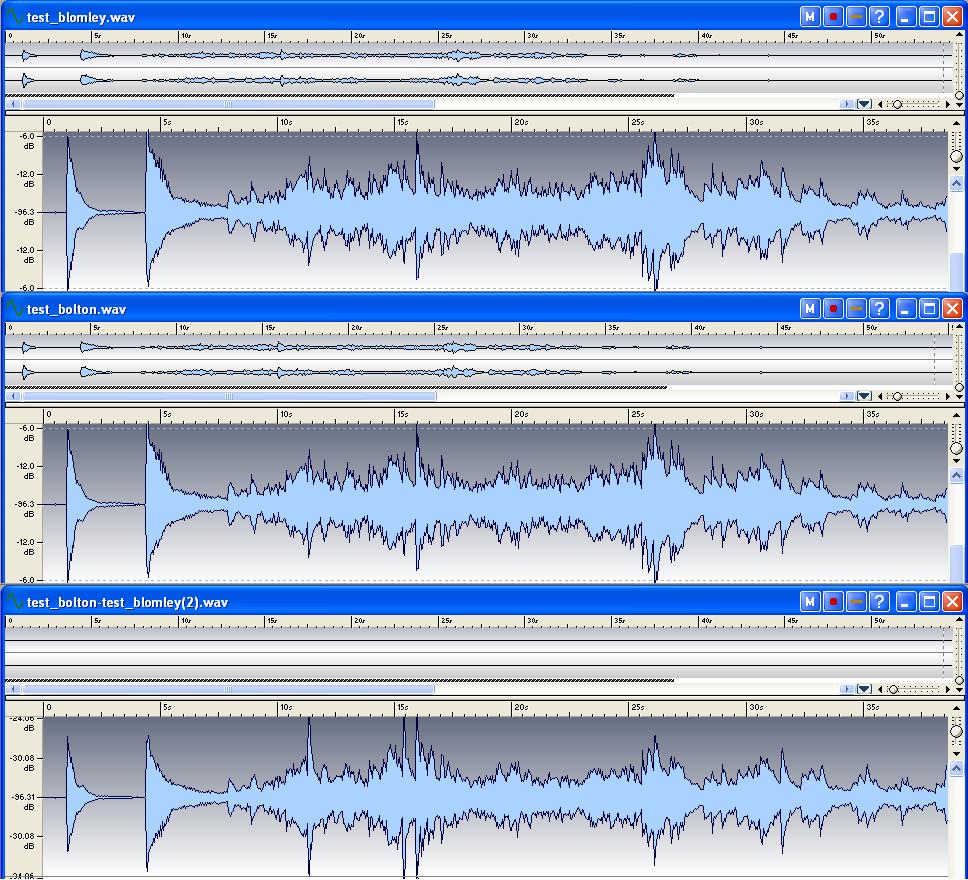

DiffMaker says there is a respectable sample rate drift. What was your recorder?
Finally the null achieved is low [21.4 dB (L), 21.6 dB (R)]

I can not depict any harsh distortion listening to the diff file. My wooly ears say I listen to the original files through an attenuator. Visual inspection of files says otherwise!

George, the files are shifted about one sample (20 us). There is not much chance to avoid it as playback and recording are independent, so the sampling does not start at the same moment.
Sample rate drift refers to drifting of sample rate along the file length.
It is not affected by the time shift btn the two files (I tested it).
Your files had a sample rate drift of –2.6ppm
Mooly’s Direct WAV file has 0ppm drift (and the other files Mooly posted had a drift of -0.01ppm to –0.03ppm.

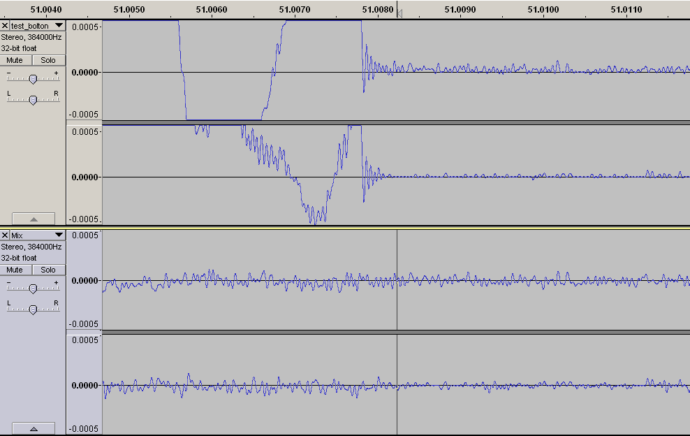

Starting to look at Pavel's files with Audacity - and this is telling me, yet again, that DiffMaker is not up to it; I'm already up to 50dB down nulling, and I still have some way to go ...

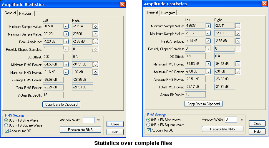

What is interesting, so far, is that PMA's setup between the two configurations has introduced an anomaly between the channels where the gain is significantly different between left and right - the overall null is better in one channel versus the other. So, I'll have to split the channels, and apply different gains to each for optimum null.
Mooly's samples, in contrast, did not show the slightest hint of this behaviour ...

To illustrate what I'm talking about, here is the end of the Direct file sample by Mooly, followed by circuitry noise - the vertical line at 51.008 secs delineates the two regions.
The Mix tracks are the nulling so far achieved between blomley and bolton, which will be limited by the intrinsic noise content.

Re volume between channels - slight difference is possible, it was necessary to set the Alps for the recording with load, as the output series resistor of 10 ohm makes a divider with 50 ohm load. The effect is in 0.01 dB order. I will post file statistics later.

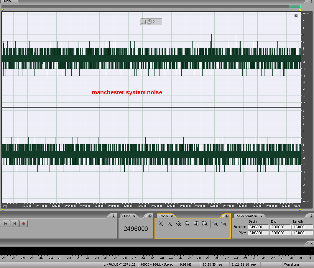

Okay, I posed a query in an earlier post, http://www.diyaudio.com/forums/loun...ch-preamplifier-part-ii-5774.html#post4111973, and no response ... the answer is Pass W is Pass 4, the last one done, and X, Y, Z correspond to 3, 2, 1.
Meaning what? Well, to my eyes it's saying that the playback/record chain was in the process of stabilising while the recordings were taking place - irrespective of how long equipment is turned on, IME, the more the paths are exercised the more they truly stabilise, and for me that is especially true whenever digital is in the picture - and Mooly's recordings are a beautiful example illustrating that behaviour: the 1st recording is a long way from the last, in terms of size of difference, in the peaks particularly, the 2nd is somewhat closer, and the 3rd almost matches the next, 4th run. A fifth would probably show virtually no difference in peak differences ...

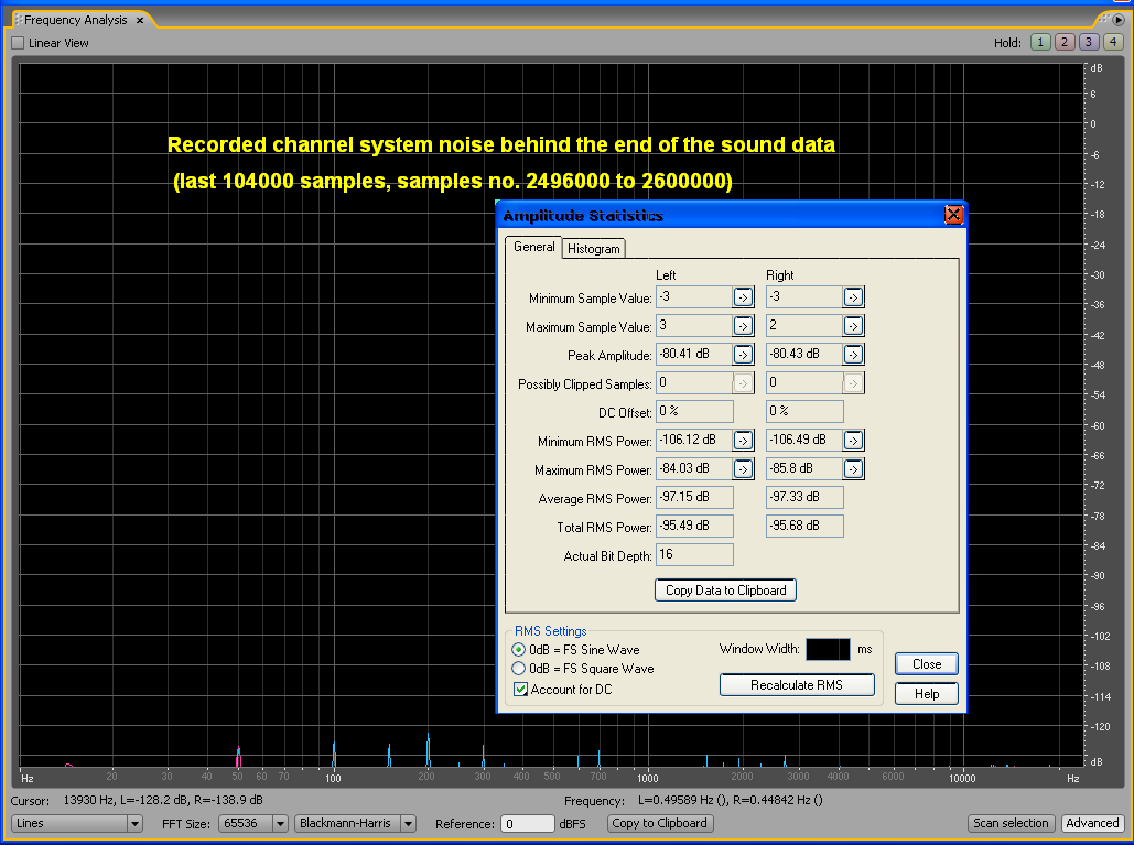

And, another consideration: Pavel's files are surprisingly somewhat noisy, only 80dB down - not random, at one place, in the region of 20kHz noise ... the nulling will be limited by this.
Yes Frank, you are right about noise. Mic input is used, which is noisier. My link input is blown.

Attached is the file statistics, FFT noise analysis and time domain noise analysis of the last 104000 samples - the system has been recording its own noise after the end of the original Mooly's file.
