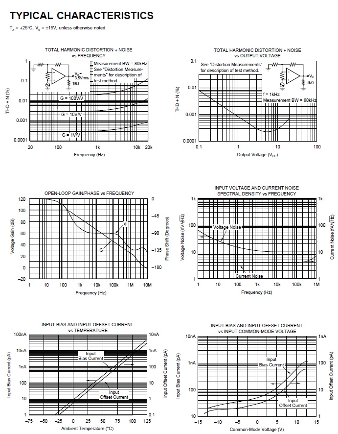

Many audio experts believe that the sound quality of a high performance FET op amp is superior to that of bipolar op amps. A possible reason for this is that bipolar designs generate greater odd-order harmonics than FETs. To the human ear, odd-order harmonics have long been identified as sounding more unpleasant than even-order harmonics.
FETs, like vacuum tubes, have a square-law I-V transfer function which is more linear than the exponential transfer function of a bipolar transistor. As a direct result of this square-law characteristic, FETs produce predominantly even-order harmonics. Figure 10 shows the transfer function of a bipolar transistor and FET. Fourier transformation of both transfer functions reveals the lower odd-order harmonics of the FET amplifier stage.
The OPA604 uses FETs throughout the signal path, including the input stage, input-stage load, and the important phase-splitting section of the output stage. Bipolar transistors are used where their attributes, such as current capability are important, and where their transfer characteristics have minimal impact. The topology consists of a single folded-cascode gain stage followed by a unity-gain output stage. Differential input transistors J1 and J2 are special large-geometry,
P-channel JFETs. Input stage current is a relatively high 800μA, providing high transconductance
and reducing voltage noise. Laser trimming of stage currents and careful attention to symmetry yields a nearly symmetrical slew rate of ±25V/μs.

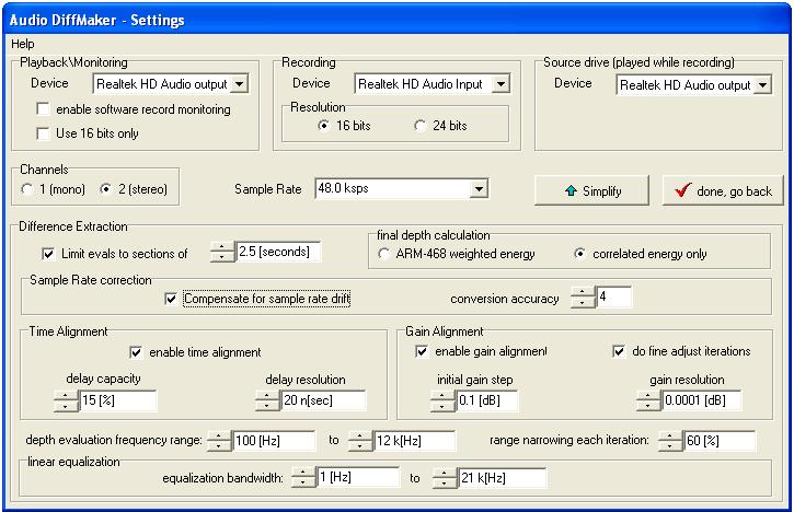

I will use DiffMaker to evaluate the differences between these files. I can post the results if you want.
That would be great. It would be interesting to see your results of that

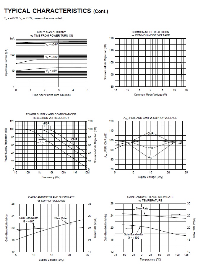

In the context of an op-amp input device this stuff is mostly marketing blather and basically wrong. An LTP of FET's or bi-polars does not predominantly produce seconds, this is EE101.

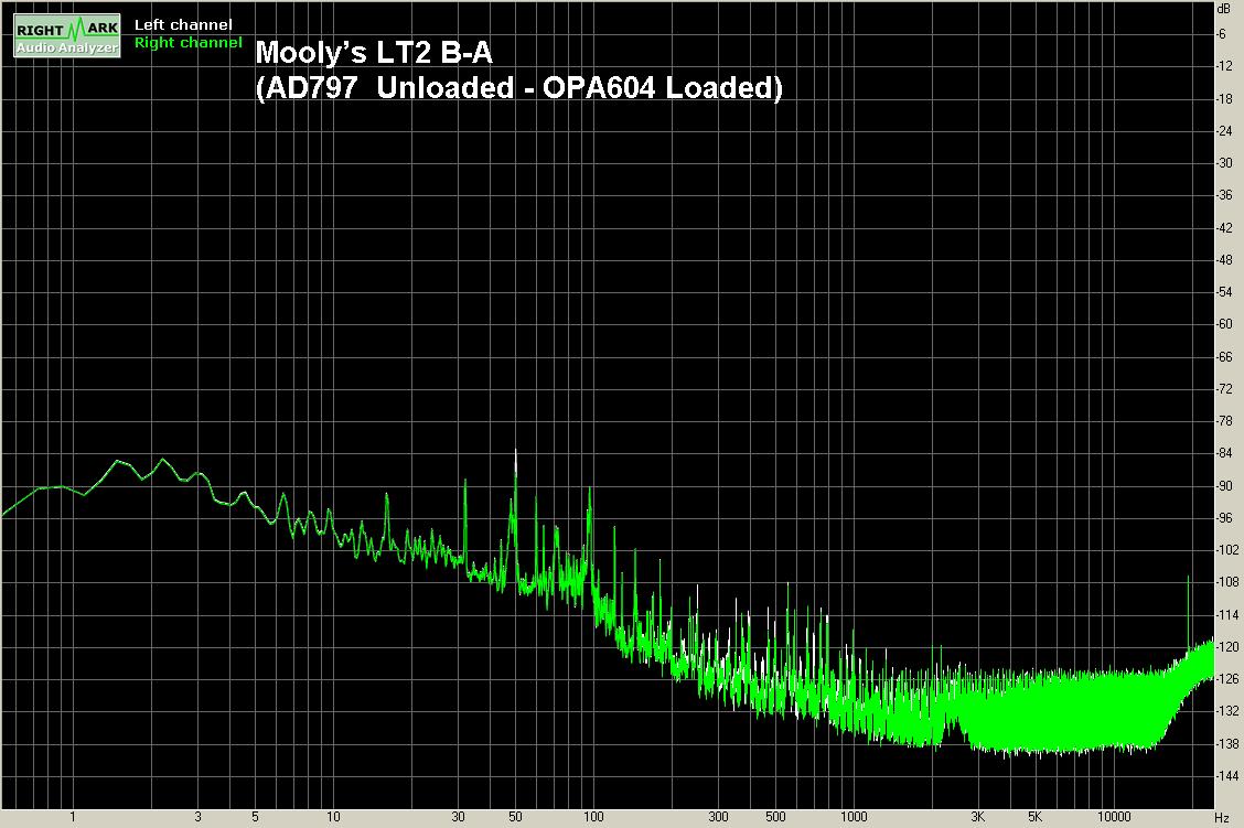

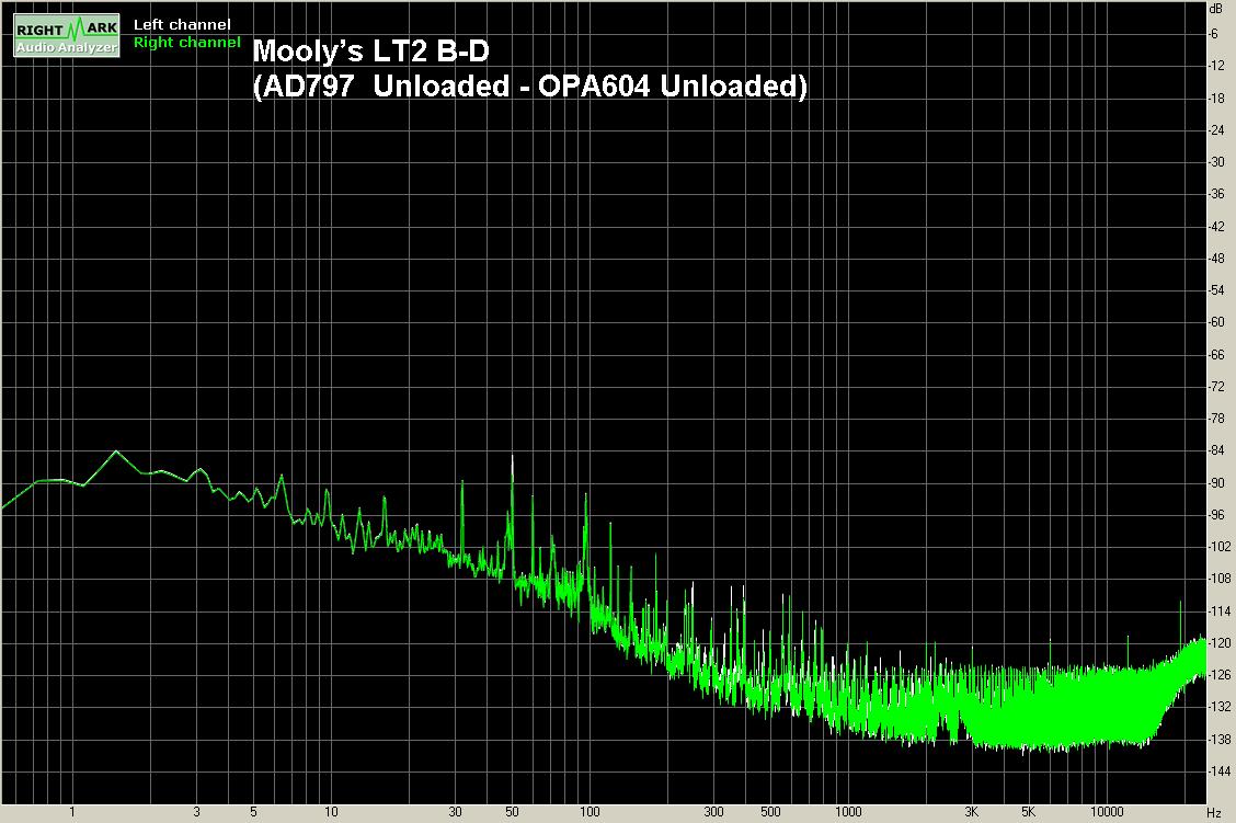

OK folks. Here is what you've been waiting for.
Results
The devices were very different. Opamp A was an OPA604 and Opamp B the AD797. I think its fair to say that the images of the distortion showed the AD797 to be far superior when driving the low impedance load with the distortion remaining essentially off the radar.
Mooly, can you please post your AD797 test circuit?
Thanks...
by seeing if the obvious huge difference in distortion was detectable in any way.

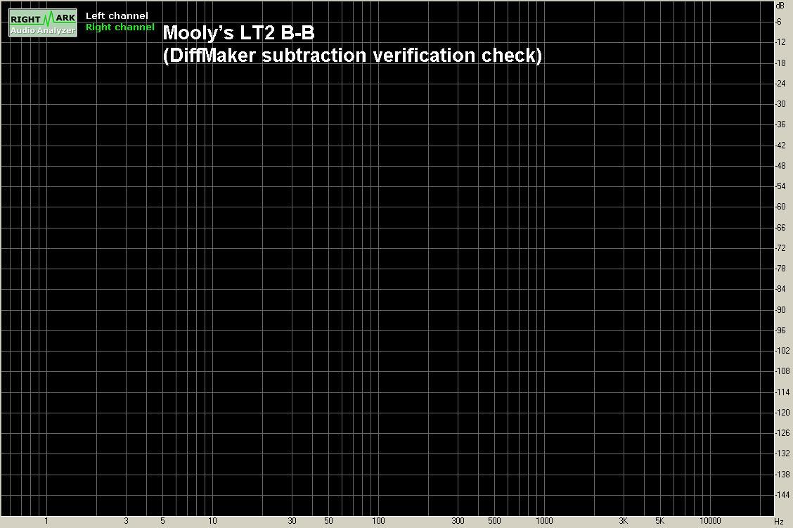

Here are the differences btn the four files.
(Audio DiffMaker SW does the time alignment, gain alignment, compensation for sample rate drift and then subtracts one file from the other. Resulting wave files have very low sound level. Turn up the volume during playback).
Mooly’s LT2 B-B
https://www.dropbox.com/s/c6vgt28cstpvt9u/Mooly%E2%80%99s%20LT2%20B-B%20%28DiffMaker%20subtraction%20verification%20check%29.wav?dl=0
Mooly’s LT2 B-A
https://www.dropbox.com/s/smkt2100ma6f5u1/Mooly%E2%80%99s%20LT2%20B-A%20%28AD797%20%20Unloaded%20-%20OPA604%20Loaded%29.wav?dl=0
Mooly’s LT2 B-C
https://www.dropbox.com/s/2fvzuvfgnulp95b/Mooly%E2%80%99s%20LT2%20B-C%20%28AD797%20%20Unloaded%20-%20AD797%20%20Loaded%29.wav?dl=0
Mooly’s LT2 B-D
https://www.dropbox.com/s/nrk5iiq2dy4t3t7/Mooly%E2%80%99s%20LT2%20B-D%20%28AD797%20%20Unloaded%20-%20OPA604%20Unloaded%29.wav?dl=0
George
Mooly’s LT2 B-B (DiffMaker subtraction verification check).JPG124.4 KB · Views: 246
