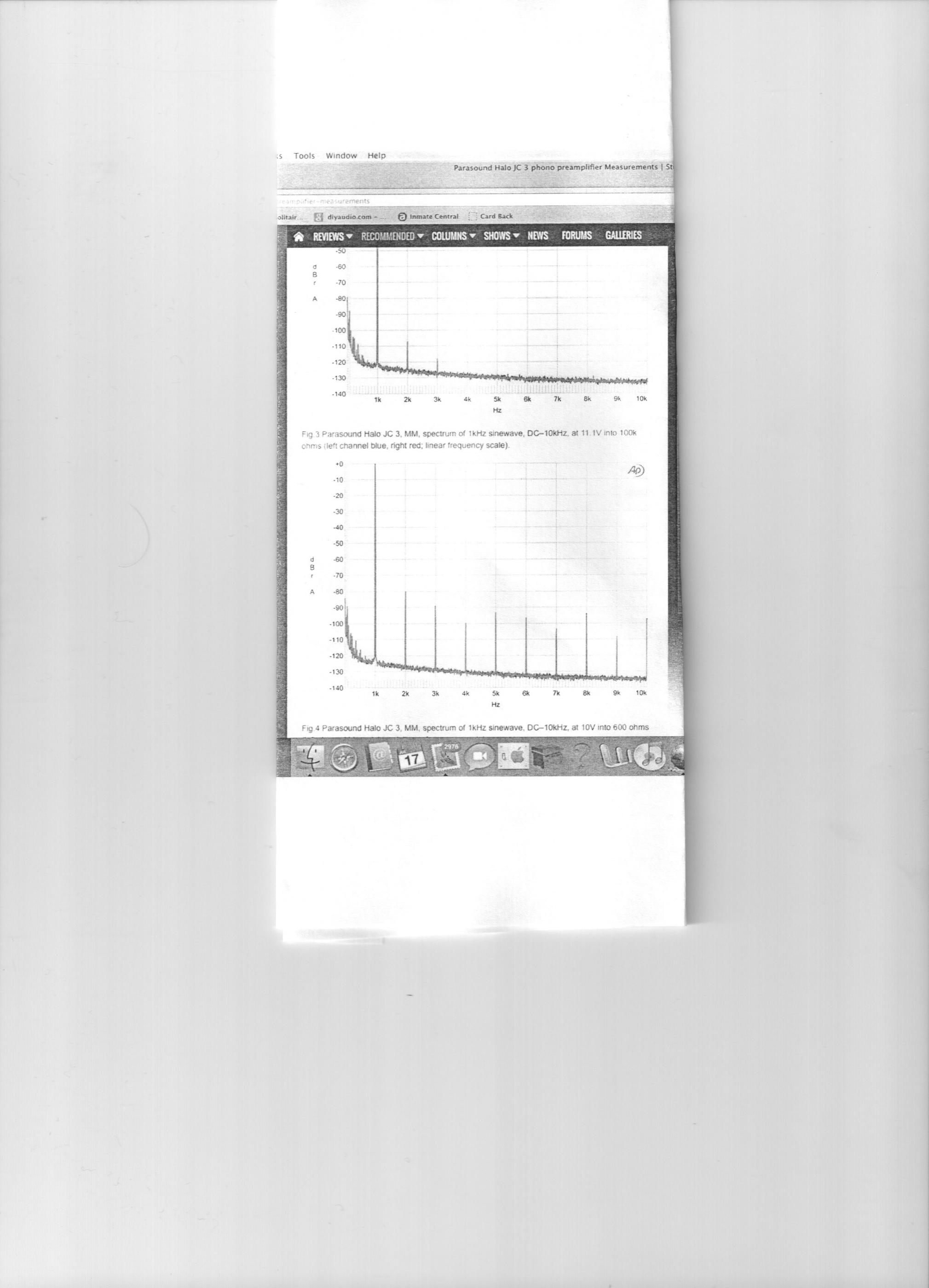

When are you guys going to understand what I am worried about? I am NOT worrying so much about an external load, but mostly about an internal resistive load due to feedback resistors and loading from subsequent stages. This is PERMANENT, not negotiable.
I'm not sure to fully understand-you, John. Feedback impedance should not be part of any OPA design, datasheets and application notes provided by the manufacturer ?
What about CFAs, that use *very low* feedback impedance, they value playing a role in their bandwidth, while responses and distortion curves are provided in their datasheets for several values of them at several gain ?
If you mean that, because of this charge, some OPA are not designed to run in class A without an additional buffer included in the loop, even with *no* external charge ? That is for sure :)
Yes, that right on the paper (datasheet), BUT when you bias op amp`a output stage to class A (ccs to negative rail for instance) you`ll hear the differnce for shure. It will sound better.
I disagree - it is a "plain engineering job" ... I see the "problem" as being that the wrong things are constantly being looked at as being the solution for the issues; and that how much progress has been made is measured in ways not sophisticated enough, by a long shot.
Once one pays attention to the areas which do really matter, to qualities which subjectively are very important, then very effective improvements can be made, using very straightforward engineering approaches ..
That is what I said : we don`t know what to measure (in some cases).
