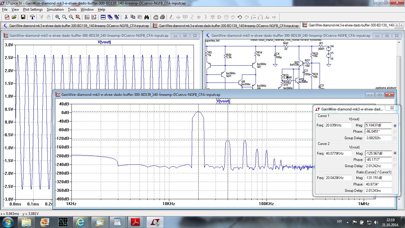

Is it that good enough? Headphone amp, THD20k at 5 Vpp on 300 ohm load.
Damir
That JFET buffer is nothing to call home about. No problem to build a class A bipolar discrete buffer with 200mA idle current and almost zero distortion anywhere even if loaded.
I don't mind bipolars. Often their higher trans-conductance than jfet is more important in many circuits. But in opamp buffers, the issue with my ears is always the added NOISE. Do you think JFET does not have advantage here?
Make a comparison with a low noise SOTA class A design that measures below -120dBr and has no high order harmonics, and then tell me.
