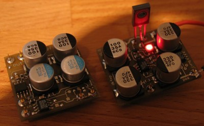

I cooked up this simple supply for crystal oscillators for just this reason: http://www.diyaudio.com/forums/digi...sb-interface-audio-widget-92.html#post2863700

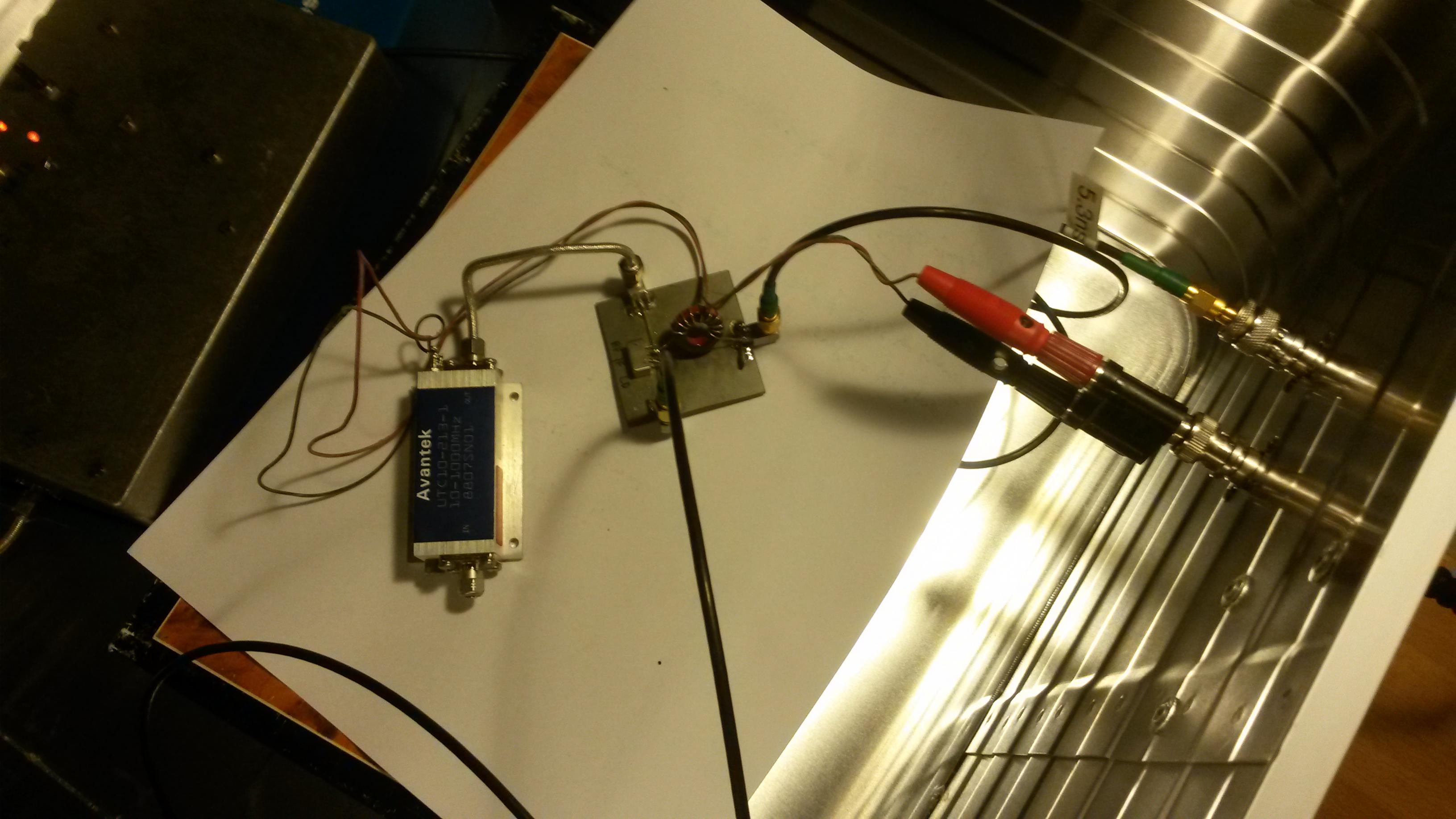

Yeah! how could I forget this! Mixing dirt onto an otherwise perfectly good carrier
is somehow against my dearest habits.
But, no need to buy from Quantec: In the junk box was an Avantek wideband amplifier,
54 dB from 10 MHz to 1000 MHz. Given that Avantek has been bought by HP, it must
really be prehistoric. I screwed an 50 Ohm SMA load on its input.
The junk box also had a test board with a MCL TUF-1H ring mixer that
was used as a phase discriminator recently.
The LO port of the mixer got +10dBm / 100 MHz from a R&S SMPD signal generator.
The IF port got a 120pF/???uH/120pF low pass to protect the AF preamp from
too much RF.

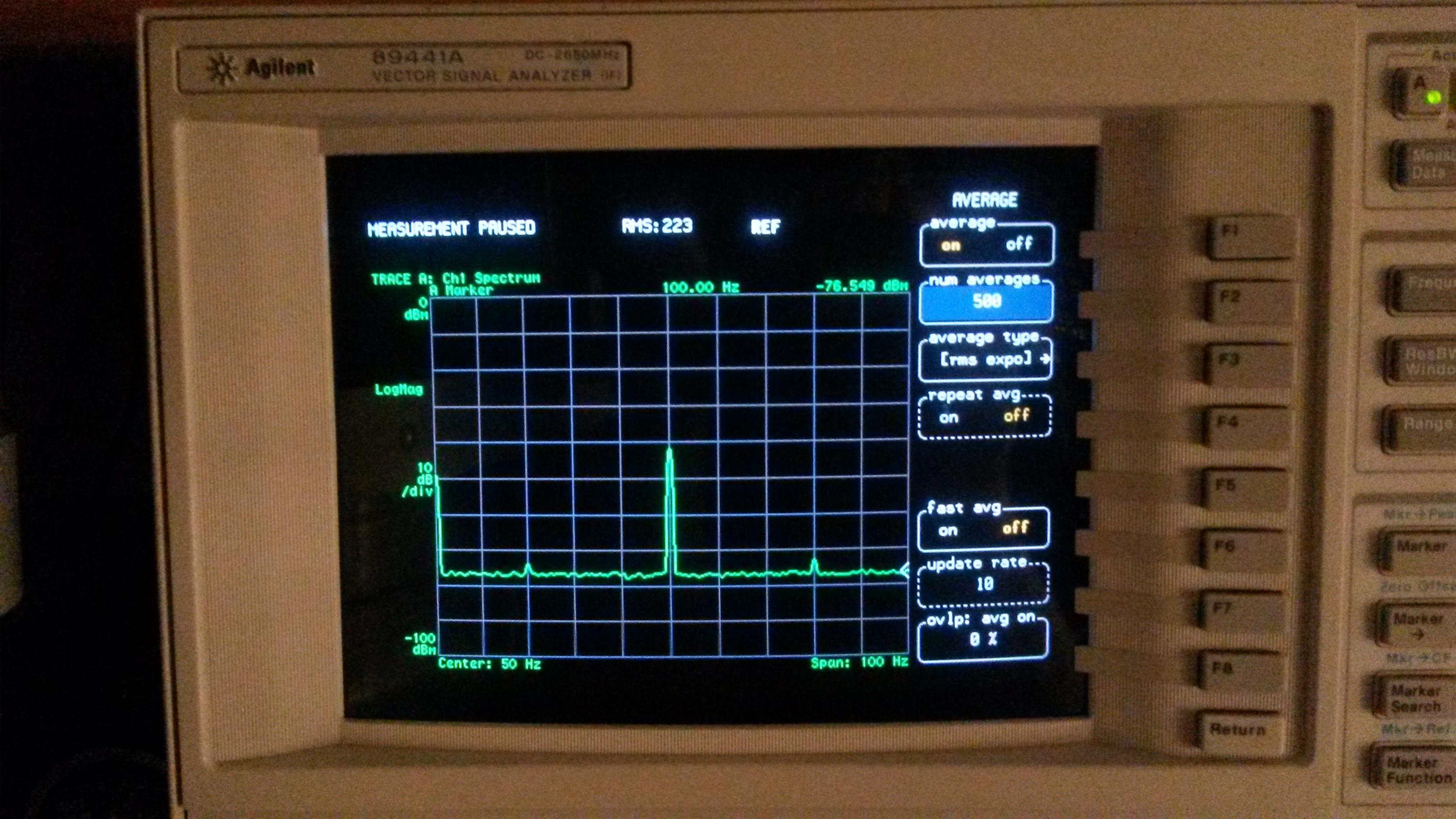

Then came my usual 20*ADA4898 AF preamp with 40 dB of gain only, then it went
into the Agilent 89441A. With enough level to to swamp the built-in 1/f noise:
It is as flat as can be, even on this DC to 100 Hz FFT.
OK, you cannot escape the mains spur ( which has 30 Hz sidebands, funny...)
When I switch off the 100 MHz generator, I see the FFT analyzer's 1/f noise
somewhere in the cellar.
What is interesting is that the 230 or so averages for 0..100 Hz took _much_ longer
than the 200 averages for 0.1 to 1Hz when executed under control of my program.
